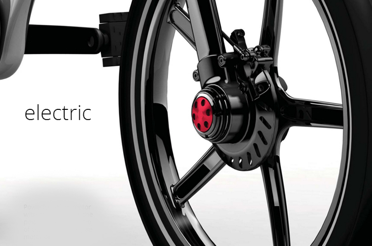

After reading another thread (or two), I was thinking about that motor. It's very powerful yet tiny. We were racing around Redbridge on a pack of these bikes. I'm 100kg, but the speed was in the mid 20s a lot of the time.
It's a shame that we can't use this motor, or a derivative, on other bikes. It would be perfect for the E-Brompton, but they're a competitor to Gocycle. Brompton could at least learn a lot from that motor and make their own version.

does it look like a hub motor with internal hub gear to you?
19,476
16,421
that is one very elegant motor.
