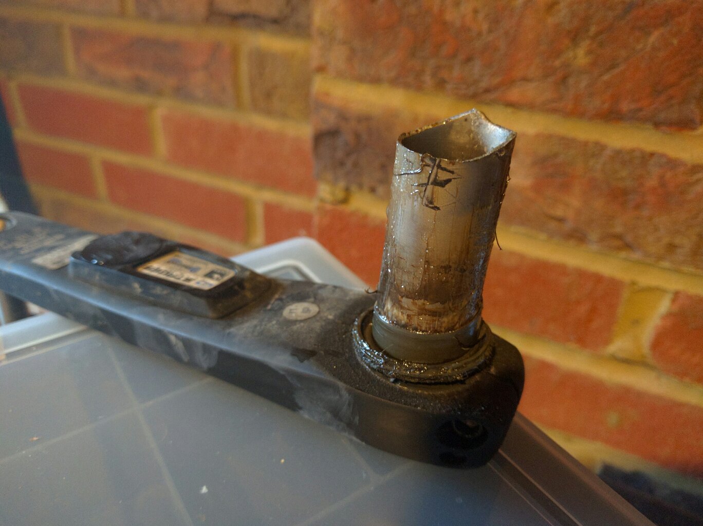

He's a small sample of hollowtech II failures findable on the web. All separate, all verifiable. Many severe injuries. At least one death.
A small percentage of those is use; and if those odds are acceptable to you, ignore this.
If not, an ounce of prevention just might save you from becoming a statistic.

Hard to see what the user could have been done to prevent those catastrophic failures.
No amount of lube will stop a crank shearing, and even with the broken axles it doesn't looks as if corrosion played any part.
Possible the axle somehow seized, but once again lubing the tube internally wouldn't stop that.
Most of those crank failures a shear failures. Shear failures start with stress risers. Rusting causes pitting.
Waxoil is not "lubrication", but rather a rustproofing fluid used to prolong the life of steel. It works by excluding water and air from bare metal and by slowing the progress of existing surface rust using phosphoric acid rust inhibitors.
No rusting, no pitting. No pitting, no stress risers.

Seems to me unlikely painting any fluid on those cranks would have prevented them shearing.
The axle failures are a bit more complicated, but I reckon the tube is simply not strong enough as manufactured to resist the various forces applied to it.
Painting it with something is not going to make it stronger.
Most of Shimano's kit is decent, but the company does have a track record of using buyers to beta test products.
Alfine 11 hubs and eMTB motors are just two examples.
I don't pretend to be a Hollowtech expert, but I bet the latest ones are strong enough to do the job.
