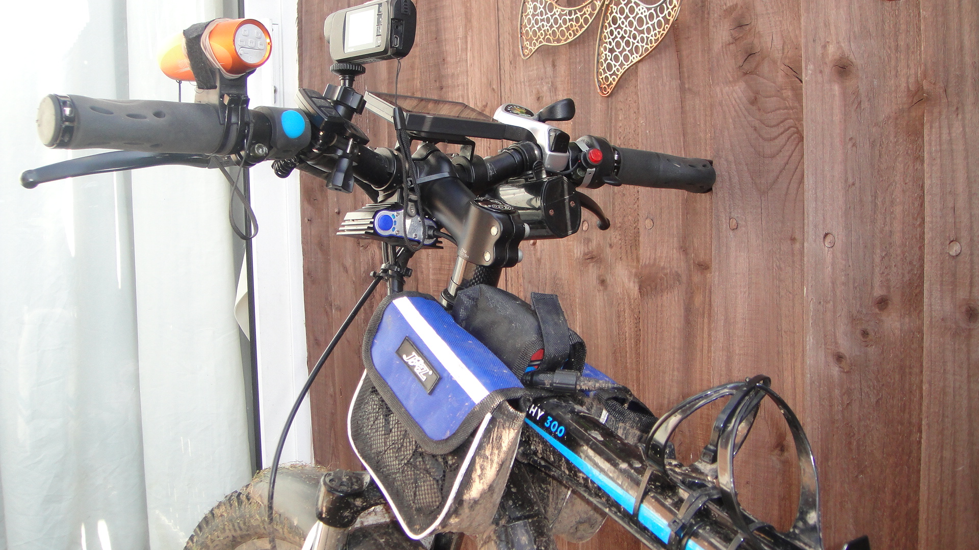

Hey. Can some expert tell me is that possible to unlock my bike?On flat terrain i can't be faster then normal bike. Even if i push hard to pedals i feel like something wont let me be faster:p. For sure its about speed limit. Maybe there is a chance to unlock it with some soldiering as i saw on this forum. for 99% it's brushless 250w bosh 36v. I bought it from second hand 2 years ago.
52,791
30,369
Soldering the shunt in the controller will only increase the power a little, it doesn't increase the speed.
Deleted member 4366
That display thing on the handlebars is only a battery meter. It doesn't have any control function. If there's a way of releasing your speed limit. it's in that compartment under the battery. You need to show a photo of any wires from the controller that don't go anywhere, i.e, not to the motor, battery meter, pedal sensor or throttle.
