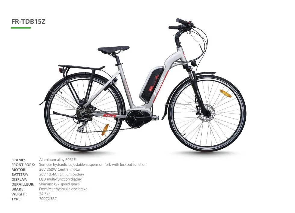

This one (Chinese) follows the same idea:
This is very bike is very different. Completely different actually. There are so many differences it's tricky to know where to start. It's a generic Chinese frame built to a tight budget for a mass market. Nothing wrong with this kind of bike built to be rebadged and sold at a keen price, but a Nevo it isn't.
The Nevo is very expensive but absolutely superb for someone who wants to ride what, in my opinion, is the best step though in the world. It's solid and handles brilliantly.

David, I did not compare the two bikes, having seen neither in the flesh.
I said the Chinese bike follows the same idea, there is no need to go further.
