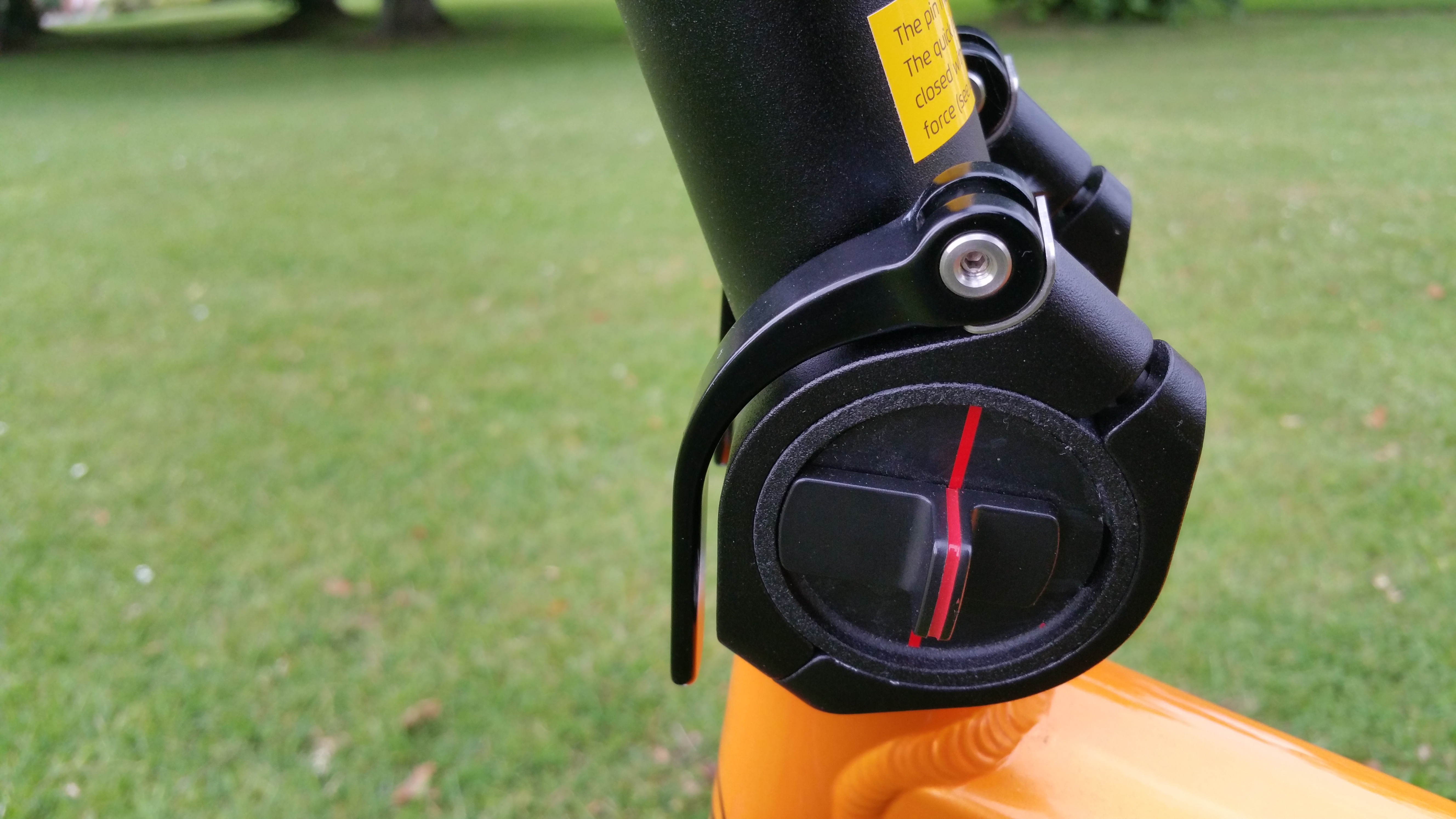

A key aspect of this bike is that it is marketed as a ‘family bike’ in that it can be easily adjusted for riders of differing height. The angle and height adjustable stem and the very long adjustable seatpost make the Pony suitable for those from around 5ft to 6’5″.
blueLABEL adjustable stem and handlebars
To adjust the bike to your height there are a couple of levers on the stem which you need to release. On the side, you then slide back the locking mechanism and ‘click’ the handlebars into the suitable reach. Then lock the levers again. It all feels very solid and secure.
Helen: It’s worth pointing out that I’m 5’3″ and struggled to get on/off the bike with the seat at its lowest setting. So if you are close to the minimum height it’s worth seeking one out for a test-ride before purchase just to make sure.

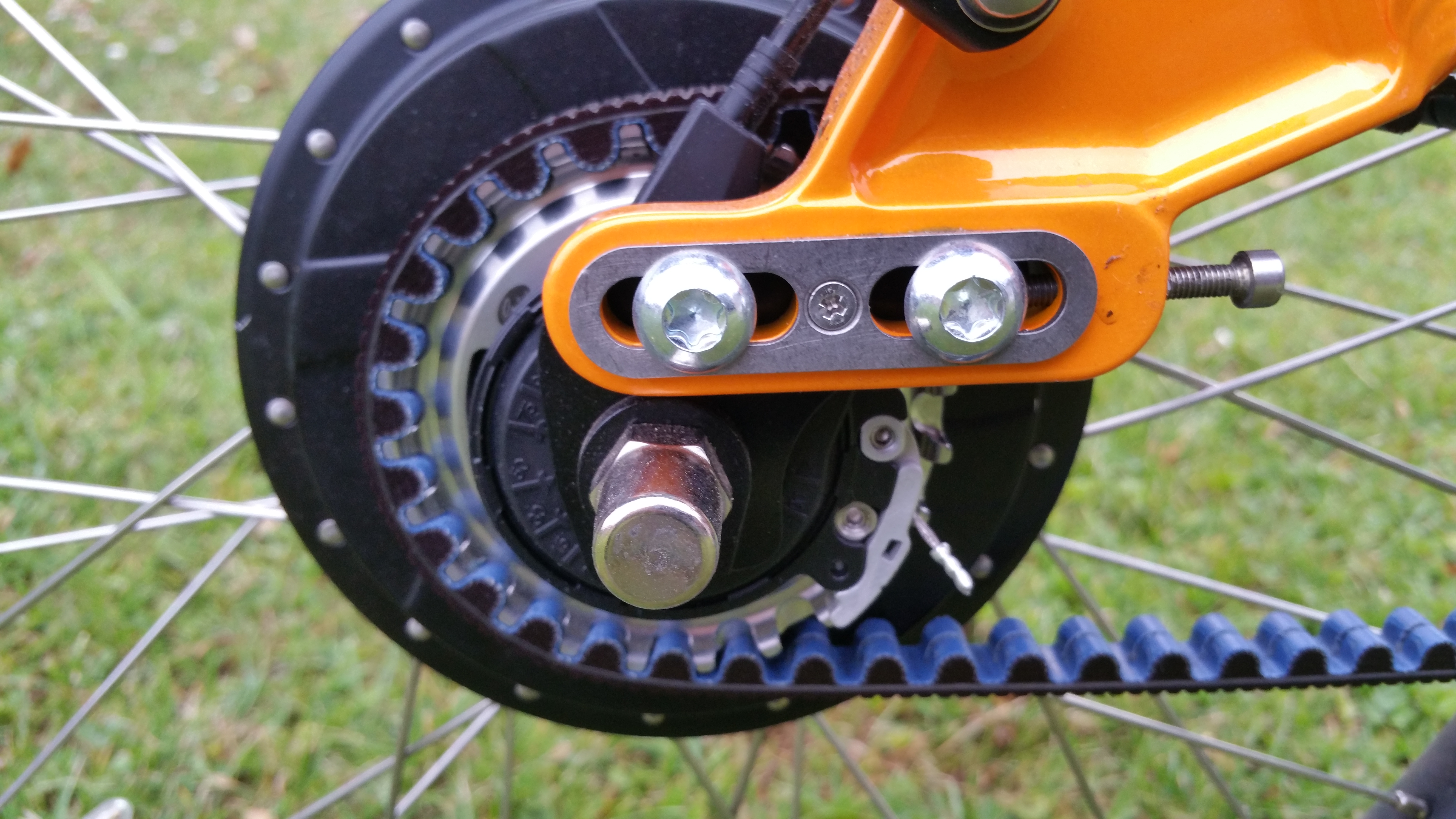

Gates Carbon Belt Drive
This model of the Pony comes with a Gates Carbon Belt drive. There are a number of advantages of this system. There is no oil, they are clean, quiet and resilient. The Gates belt is constructed from continuous loops of carbon cord inside a polyurethane/nylon jacket.
The Carbon Drive belt does not stretch over time like a chain and should therefore last between 2-4x the lifespan of a regular chain. This means you don’t have to re-tension the belt, or replace the belt due to stretch.
The downsides are that the belt operates at a lot higher tension than a chain resulting in a slightly less efficiency but this is not really noticeable as you have the Bosch Performance Line motor to offset it. It takes a bit more effort to set it up correctly (although you won’t need to do this from new).
Gates carbon belt drive blueLABEL Pony
You may have noticed that on normal bikes with a chain, the chain goes through the rear triangle and to remove/attach it you’ll need to pop a link. With the belt drive you can’t do that. To get around this, often the chain stay is ‘cut’ so that you feed a belt through the hole. Obviously this introduces a weak point into the frame. The Pony overcomes this by raising the rear stays so that the chain goes behind and under. Therefore the frame integrity remains intact.
The CDX version belt fitted to this bike also has a small centre ‘ridge’ in it to keep it aligned as well as help to keep the muck out and off your belt.

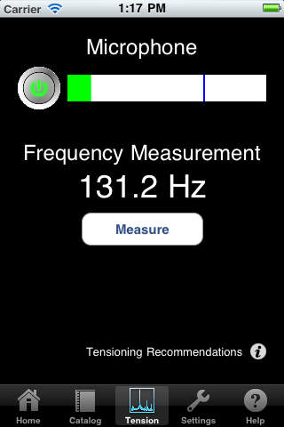

gates_carbon_belt_iphone_app
Plus, if you’ve got an iPhone then there is an app you can download onto your phone which will tell you if the tension of your belt drive is correct. You hold the phone’s microphone up against the belt and give it a twang. It’ll then analyse the sound and tell you if it needs adjusting!

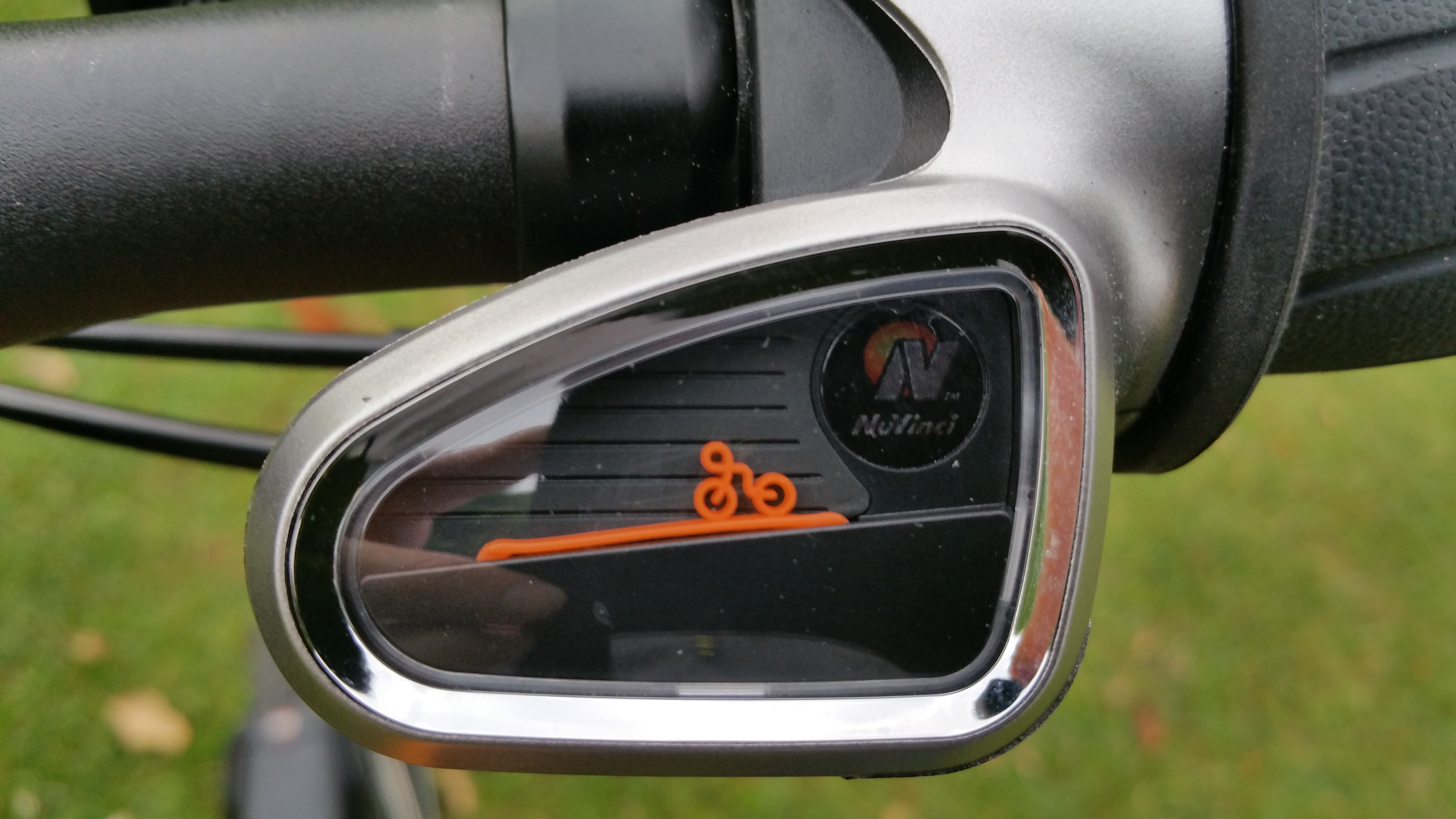

The Nuvinci comes with its own twister that sits next to the right hand grip. As you twist it, the shifter display indicates the current gear ratio as a hill for slower speeds and a flat road for faster speeds. It’s a bit of a novelty at first, but after a short while riding the bike I never looked at it again,  just going by feel alone.
Being able to change gear at a standstill is also a huge benefit, especially if you have to stop quickly and then restart again. Bear in mind it will only shift about halfway through its range at this point however. Once you start moving again then you can shift through the rest of the range.

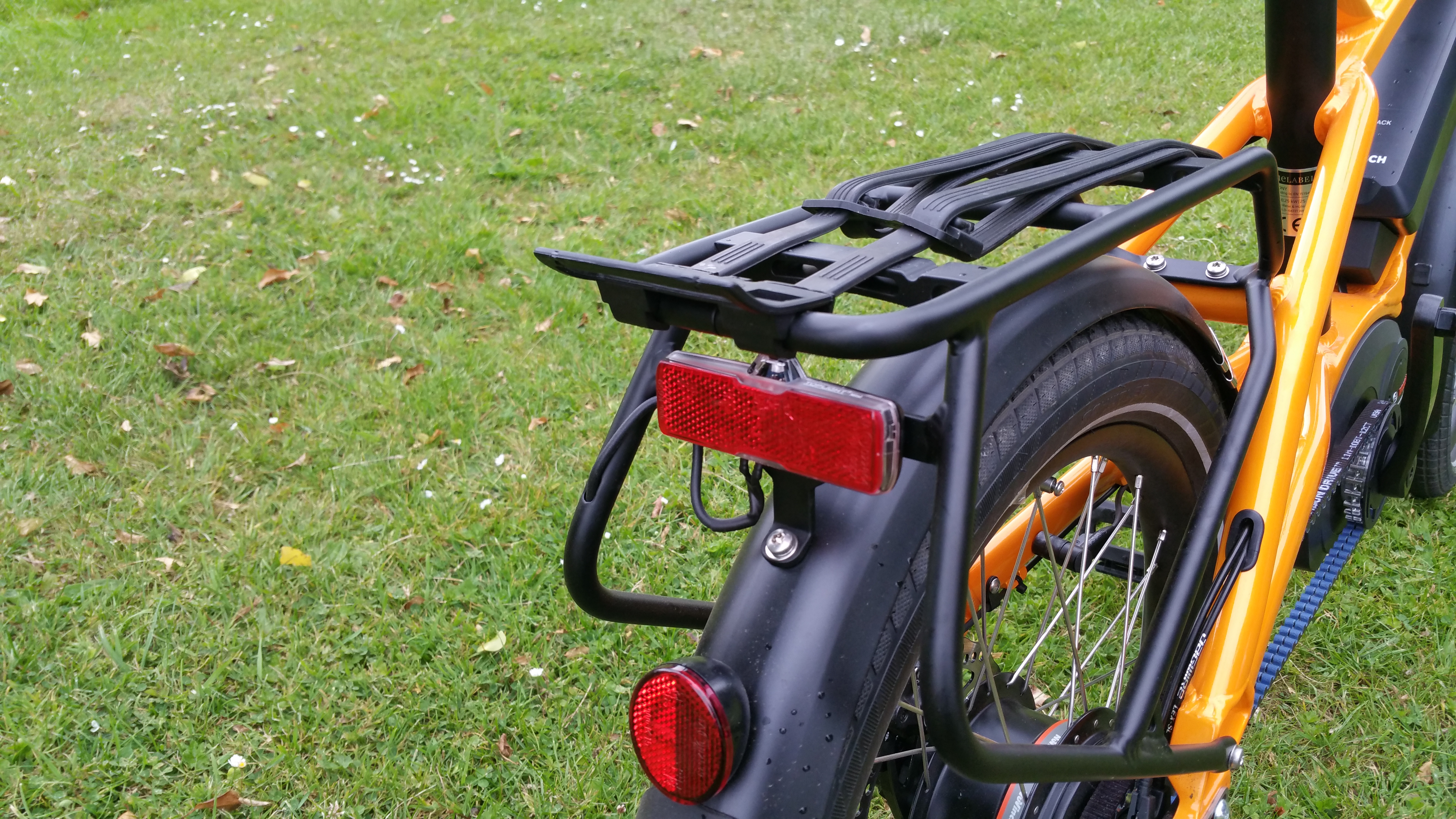

For commuting, or transporting the shopping, there is rear rack with elasticated strap which feels very solid.

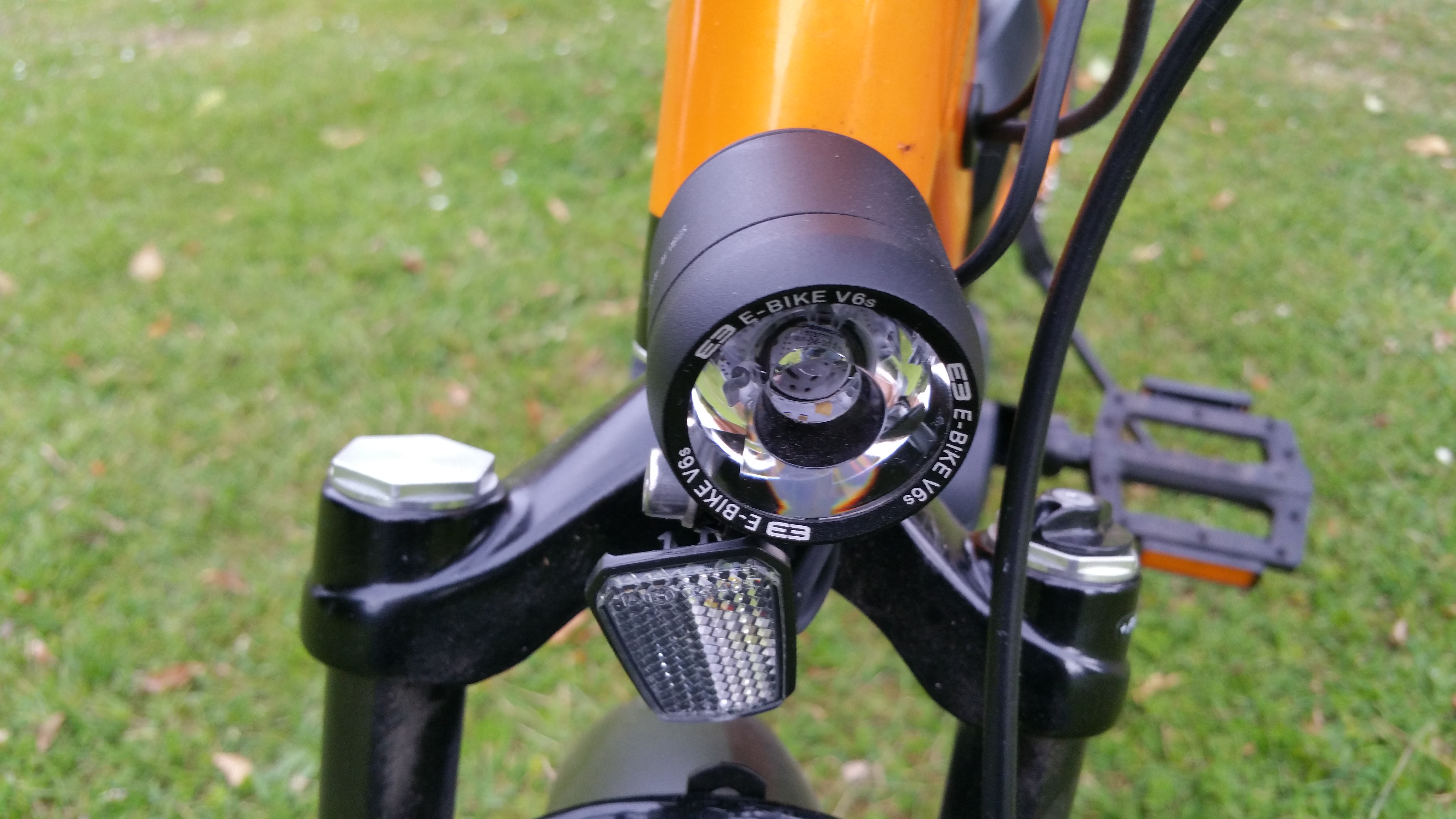

And for those short winter days and long winter nights, a compact Supernova E3 E-Bike V6s LED light is provided out front and a Busch & Muller Toplight mini on the rear.  The matt-black front light is powered by a CREE LED, putting out 165 lumens.
There are no flashing modes, just on/off. The lights are controlled by the ‘light’ button on the Intuvia console so easy and accessible and both are powered directly by the Bosch battery. Should you somehow end up depleting the battery completely on one of your rides, the Bosch PowerPack should give you up to another 2 hours illumination.
Taking the bike out late one evening to an unlit lane, the V6s has plenty of throw with a faint hotspot, enabling you to see potholes and other obstacles. It’s good to see decent lights fitted as standard – although obviously you are still paying for them – particularly useful if you commute on unlit country roads. LED lights have come on tremendously in the last few years.

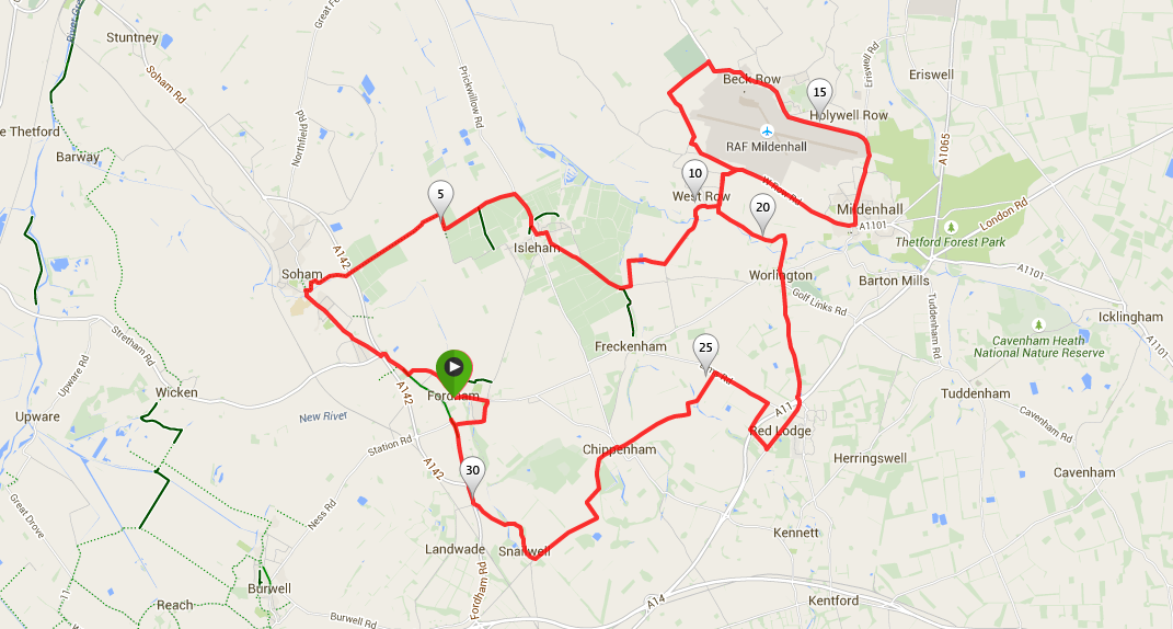

Range Test (“Turbo”)
Being a brand new bike with less than a mile on the clock the Intuvia console was reporting a predicted range of 11 miles on the ‘Turbo’ setting which is clearly much less than what it is capable of. I attached a Garmin 200 with GPS to keep track of my speed and distance. Riding conditions were dry with a fairly brisk breeze.
With 5 full bars showing on the battery level, I headed off on a largely flat route keeping the bike at around its maximum assisted speed. The Intuvia display was reporting around 16.2mph and my Garmin GPS 15.9mph so it is within the tolerance allowed by law.
  • First bar out at 9 miles
  • Second bar out at 16 miles
  • Third bar out at 21 miles
  • Fourth bar out at 28 miles
When the empty ‘flashing’ light appeared I had about 500m before the assistance stopped completely. Total distance travelled was 32 miles. This was on a open and flat route with a fairly strong breeze. As with all reviews, these figures are only representative of my riding style, weight, fitness etc. Average speed for the trip the course was spot on the legal limit at 15.5mph.
route

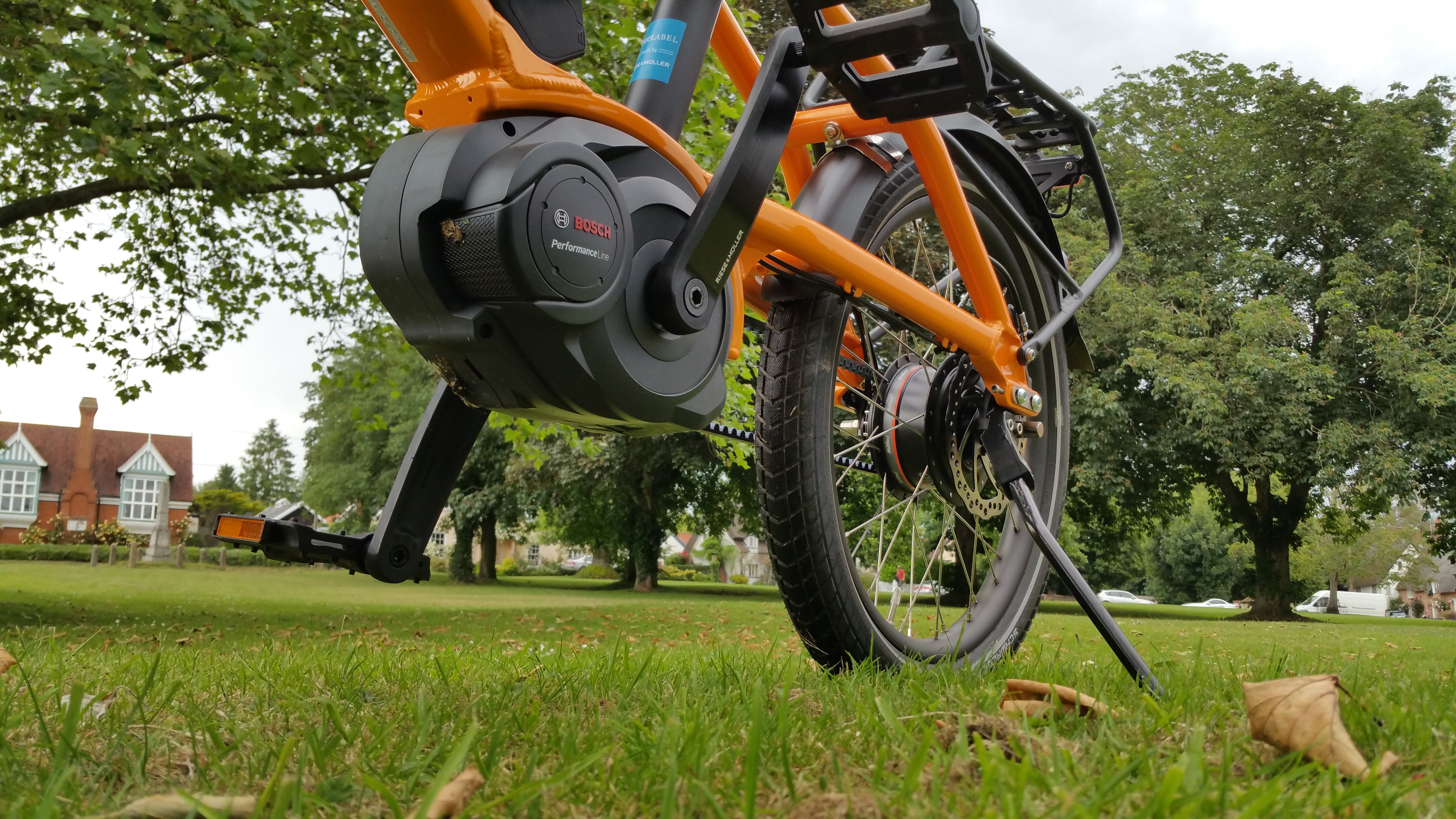

Adding the Performance Line motor to the Pony, Riese & Muller definitely intend you to use it. This isn’t a bike to scrimp on the power and ride around on Eco, it’s nippy and responsive combined with swift acceleration means it’s designed to get you from A to B quickly. It’s fun!
