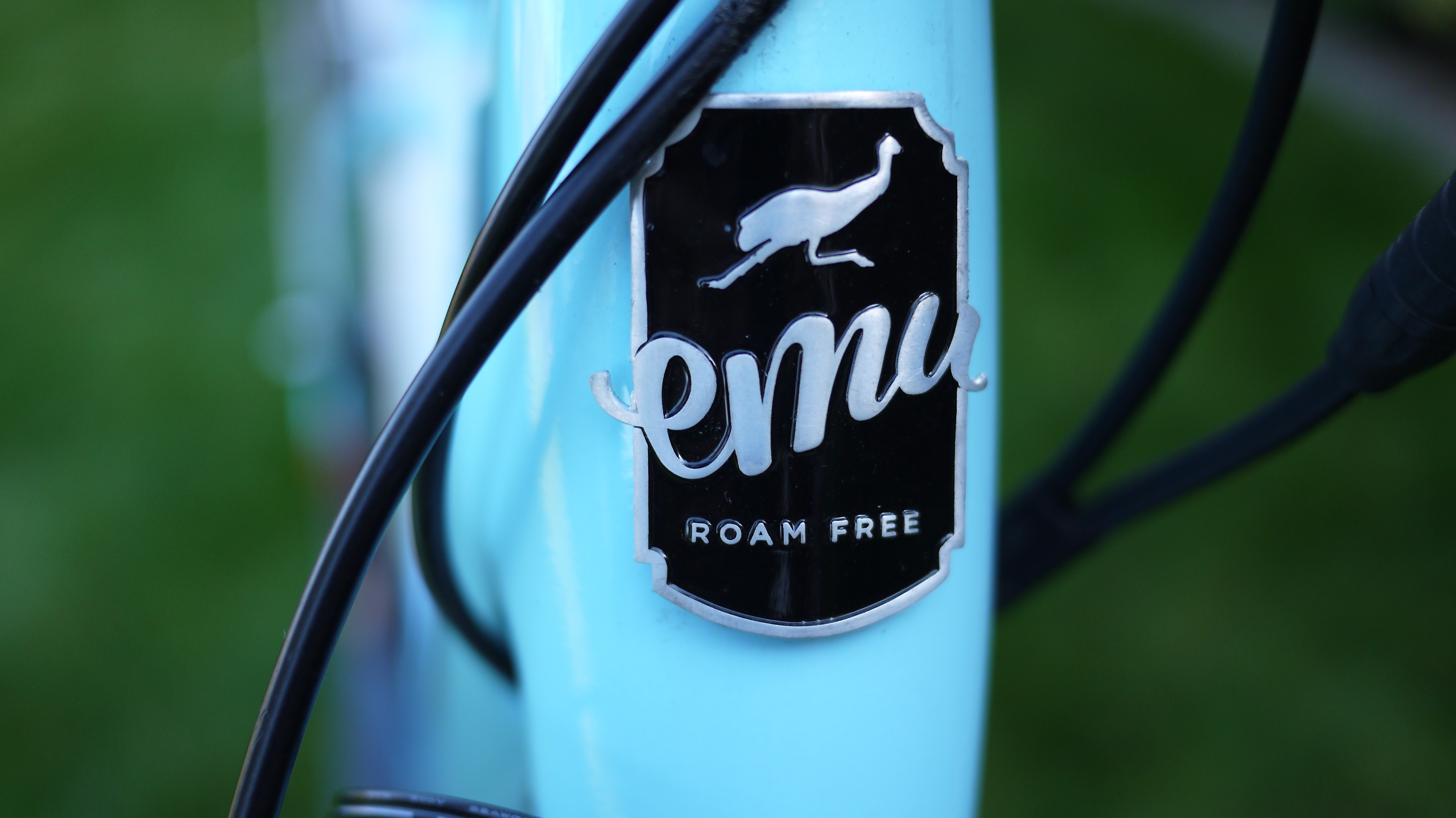

The word to describe the bike when you first set eyes on it is: Bright! The frame has been painted in a eye-pleasing – and fairly vibrant – pastel blue. The frame colour contrasts nicely with the black battery, integrated in the down tube. That contrast visually alludes to a thinner and more streamlined appearance.
In fact – and unusually for me – I actually prefer the step-thru version to the crossbar one. The crossbar’s appearance is one of relative chunkiness, especially in black.
This model is advertised on the Emu website for women, but I think they’re underestimating its appeal as a unisex bike.

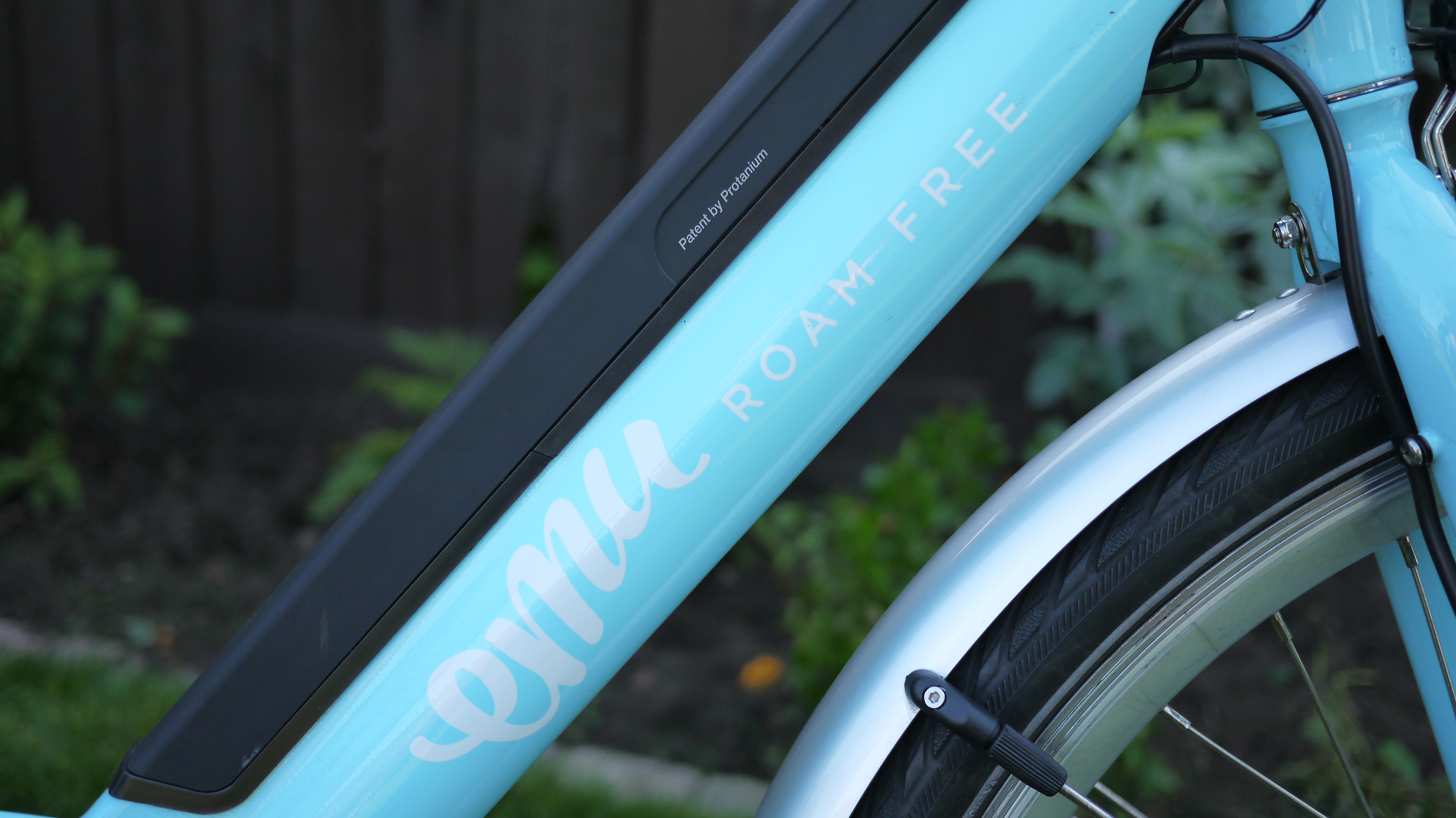

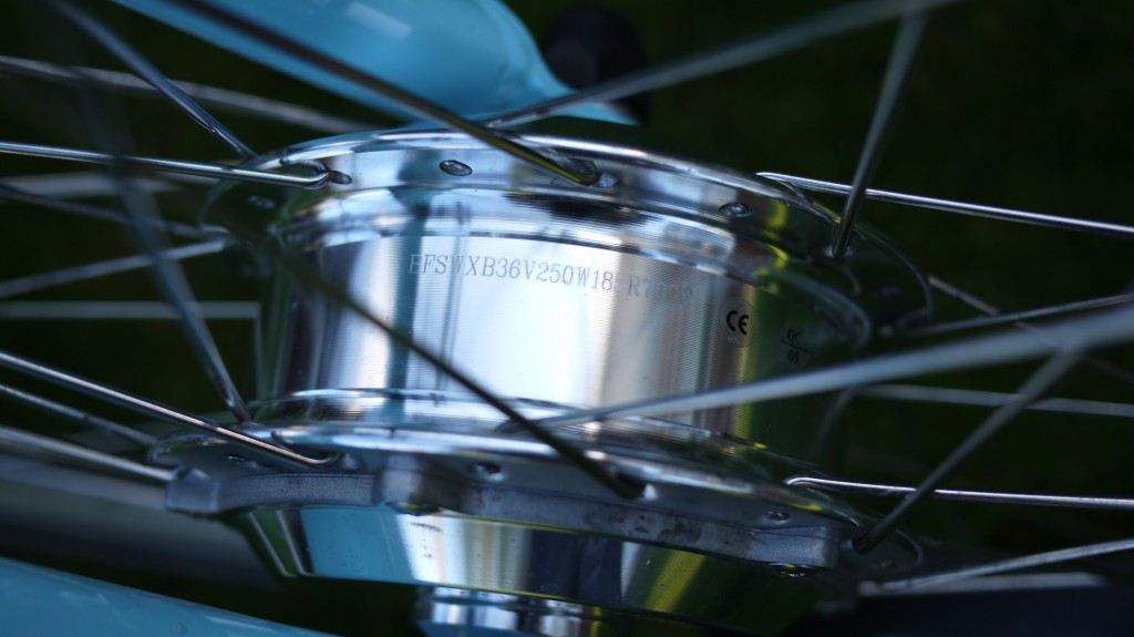

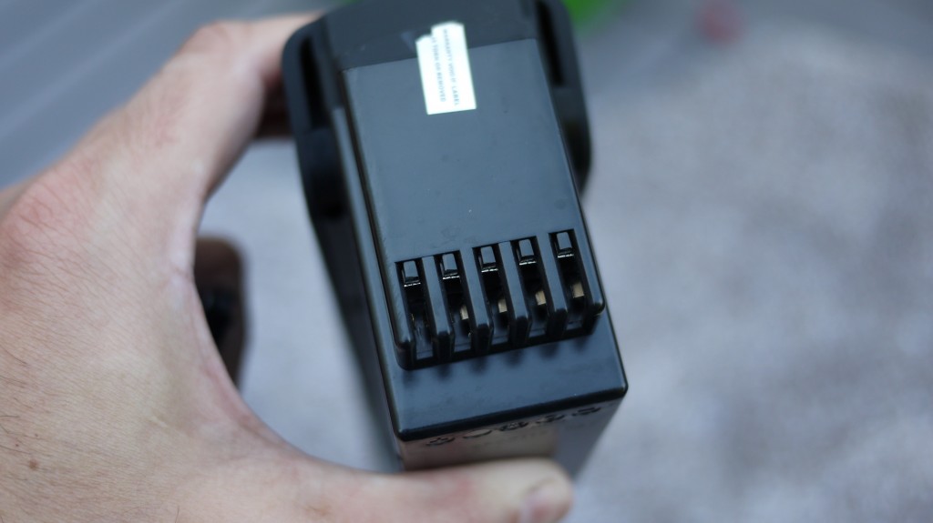

The brushless 250W front hub motor is powered by a 36V lithium battery. Inside you’ll find Samsung cells and a 10.4Ah capacity giving 374Wh at your disposal. The battery can be locked in the frame, making it more difficult for a casual thief to take it from the bike should you need to leave your bike unattended and it snaps in and out easily using one of the supplied keys.

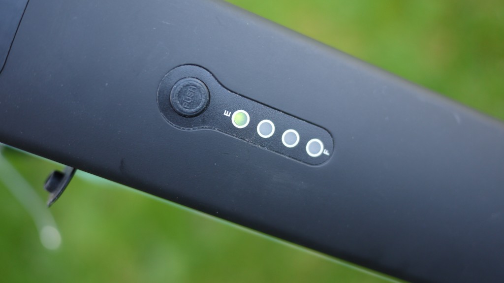

The battery does come with its own ‘power remaining’ display, through the use of four LEDs showing the capacity remaining from empty (E) to full (F).
P1030495

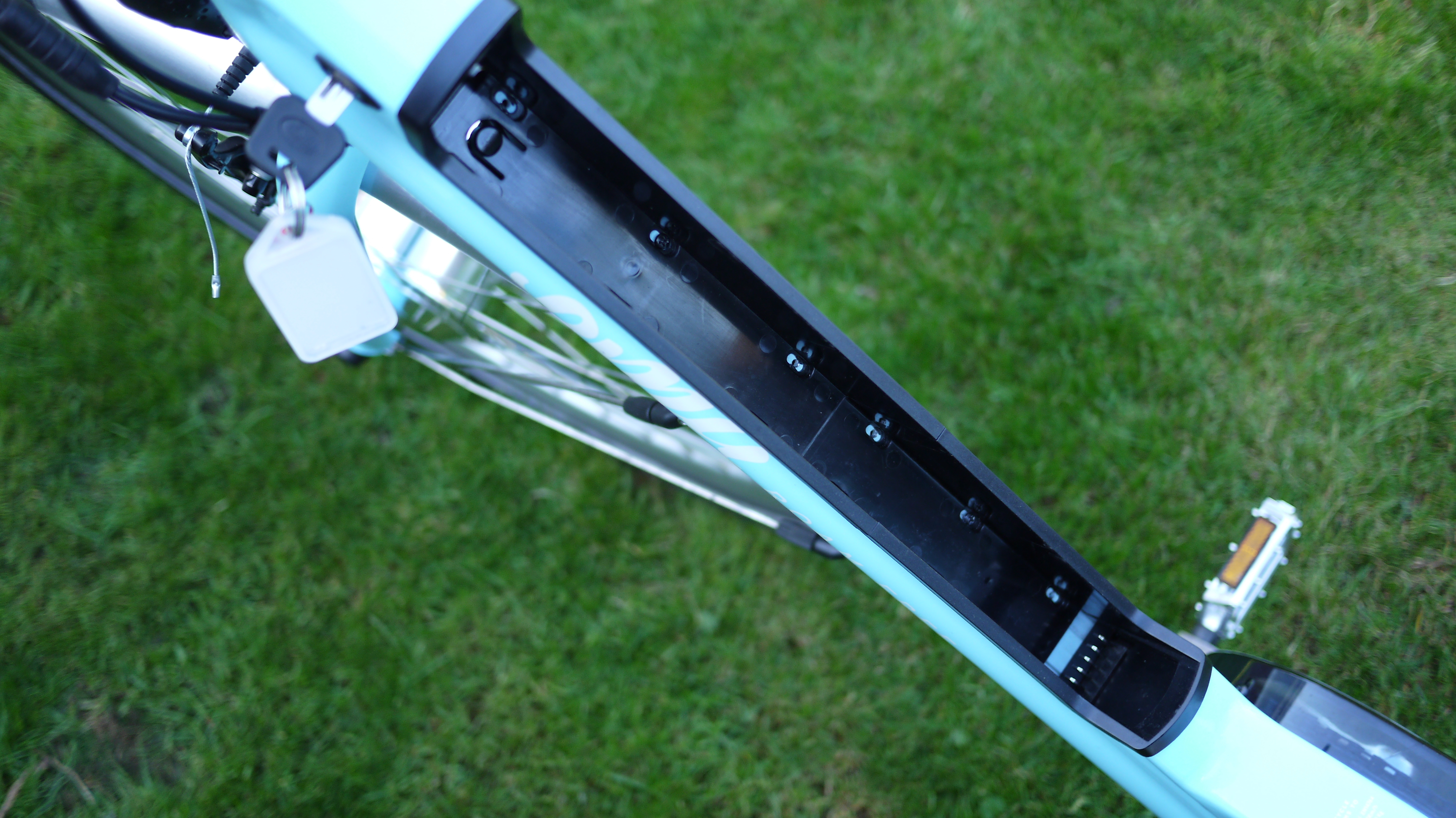

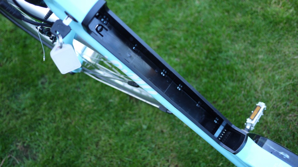

The lock is just above the top of the battery nearest the stem and the battery itself has a nice rubberised coating, making it easy to grip when removing/reattaching to the bike. It’s also quite slim too. You can charge the battery either on or off the bike using the supplied mains charger.
The charger itself is very compact, looking more like a laptop charger than the normal ‘brick’ you get with many e-bikes. This could be useful if you need to carry the charger with you (to recharge the battery at work for example).
A rubber flap on the side of the battery reveals the charging point. It took about 7 hours to recharge it from flat. While charging, a small light indicates charging progress at the top of the charger unit, initially showing amber until going green when fully charged. EMU state that they “recommend an overnight charge and a fast charger is available if preferred”.
One thing I noticed was that it was possible to leave the battery ‘on’ while charging, so make sure you press the small power button above the row of LEDs to turn it off. This is important during the winter months if you decide to store the bike and battery for long periods.
The battery is rated for 800 full charge cycles and up to 4000 half-charge cycles if used regularly.

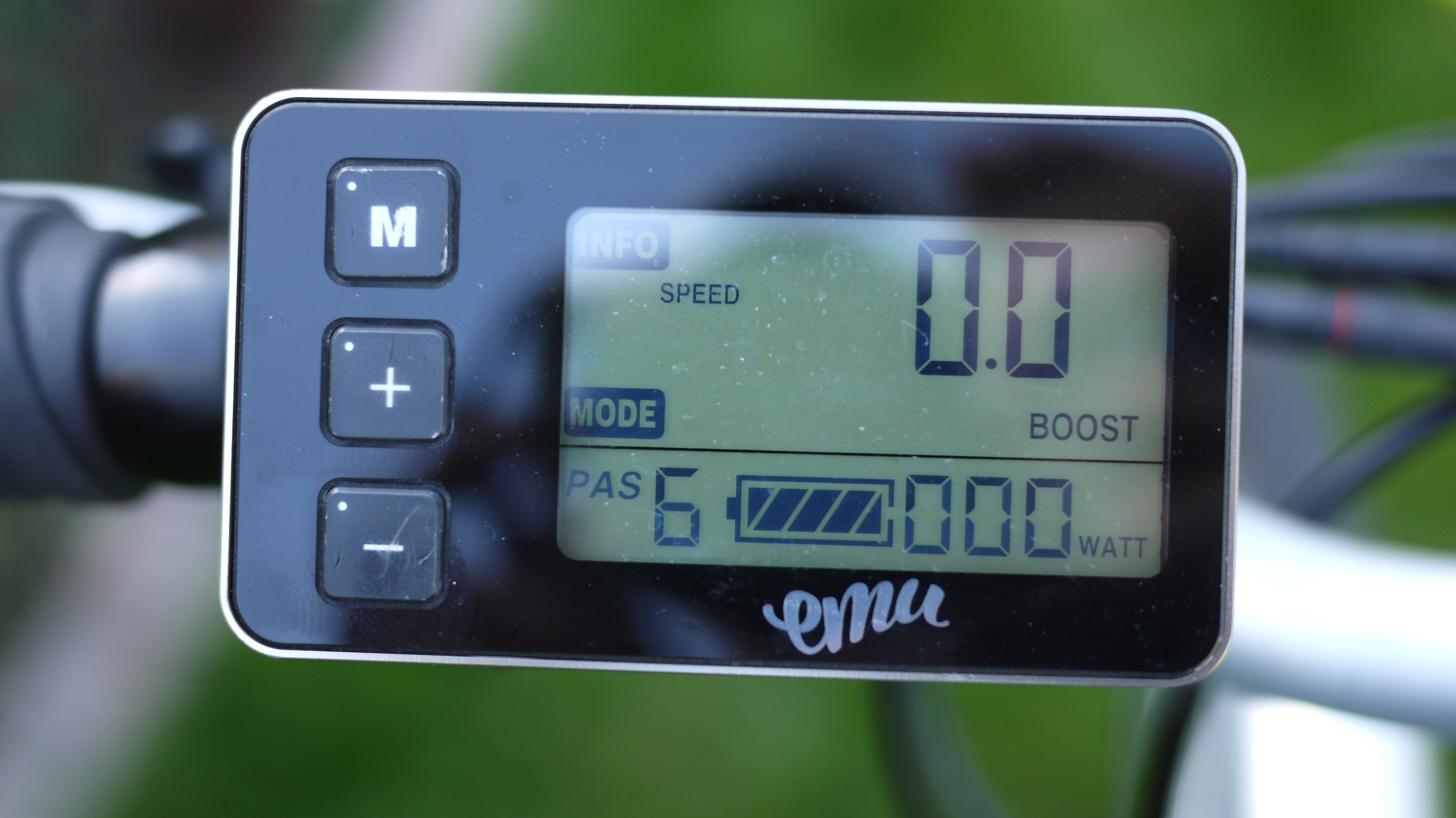

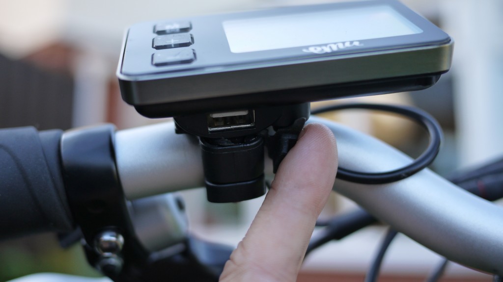

Stepping onto the bike, the LCD display is seated next to the left hand grip. To turn the bike on, just hold down the ‘M’ button for a couple of seconds and it springs into life. The display is a decent size and easy to read, giving you all the important information you need while out and about. It’s not removable though.
The top-half of the display shows you things like the current speed, maximum speed etc. as well as the current ‘mode’ or assist level.
P1030477
There are 6 levels of assist on the Emu. The + and – buttons allow you to select the assist level either when stationery or while moving. On the display, you’ll see the assist level on the bottom portion of the screen (PAS 1 to 6). PAS 0 is off, 1 and 2 (Eco), 3 (City), 4 (Tour), 5 (Power) and 6 (Boost). By default, the assist level when you first switch on the bike is level 1.
Next to the assist level is the current ‘battery remaining’ indicator, broken up into 5 bars (100%,80%, 60%, 40% and 20%). To the right of that, is the current consumption in Watts which is quite useful in gauging how much assistance the bike is giving you at any moment in time.
Pressing the ‘M’ button will also cycle through the other information such as max speed, trip and time etc..
P1030497
The Emu joins the recent trend to include USB connectors on the battery/display to charge your mobile phone, for example if you’re commuting in a busy city and want to use your smartphone’s navigation function. In the Emu’s case, the USB port is behind a flap on the rear of the LCD display.

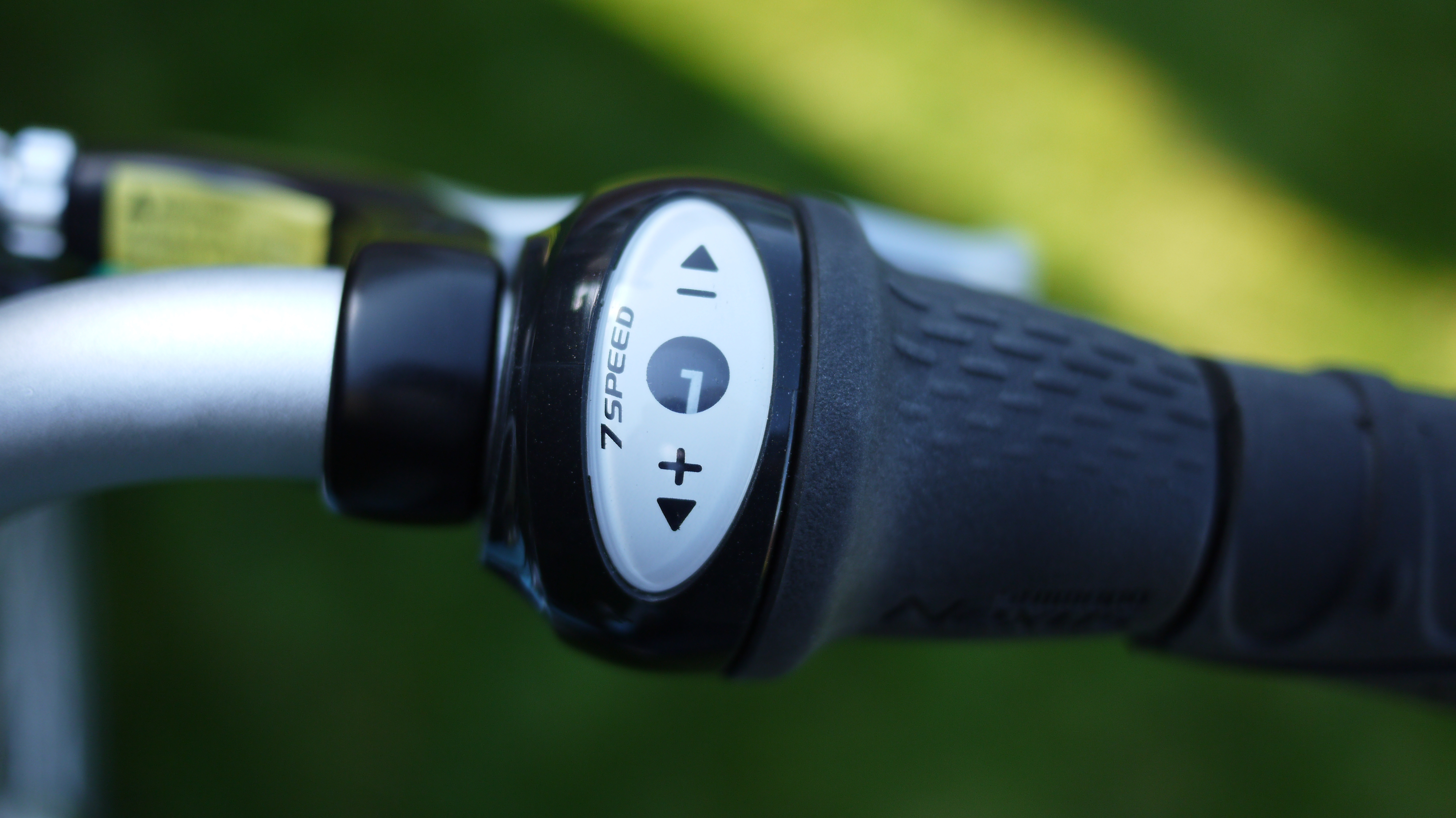

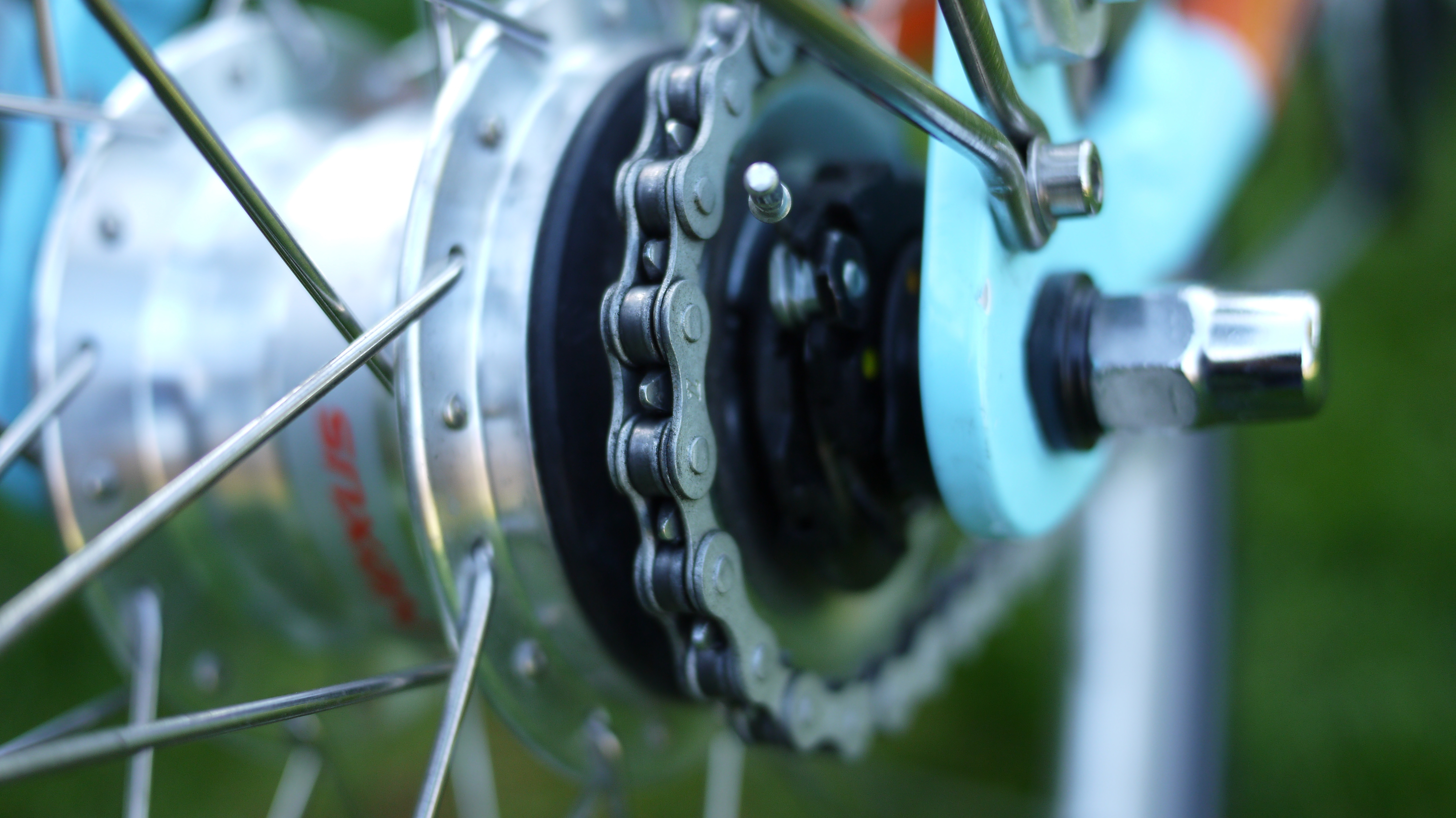

On the gearing side of things, it’s good to see that the Emu has adopted the Shimano Nexus 7 hub in the rear wheel with a twist shifter on the right grip. The shifter does have a small indicator to show you what gear you’re in, but you’ll find with hub gearing, knowing which gear doesn’t really matter. If you have to stop suddenly for example you’ve been caught by a red light, you can quickly twist back a few gears. The Nexus 7 trades range (244%) for simplicity and ease of use and although in theory, a little bit of power is lost internally compared to a higher-end derailleur setup, in practice you’re unlikely to notice.

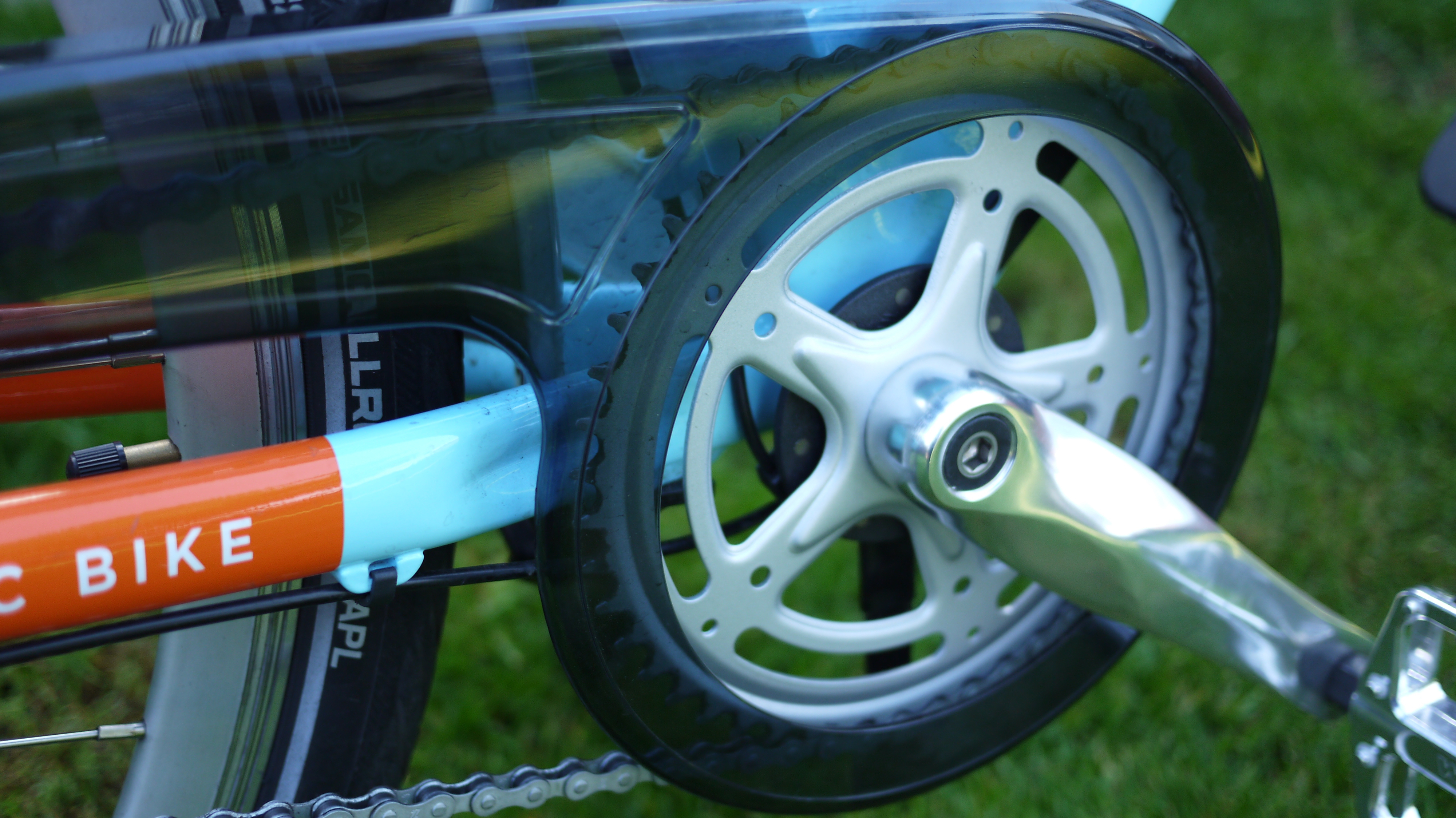

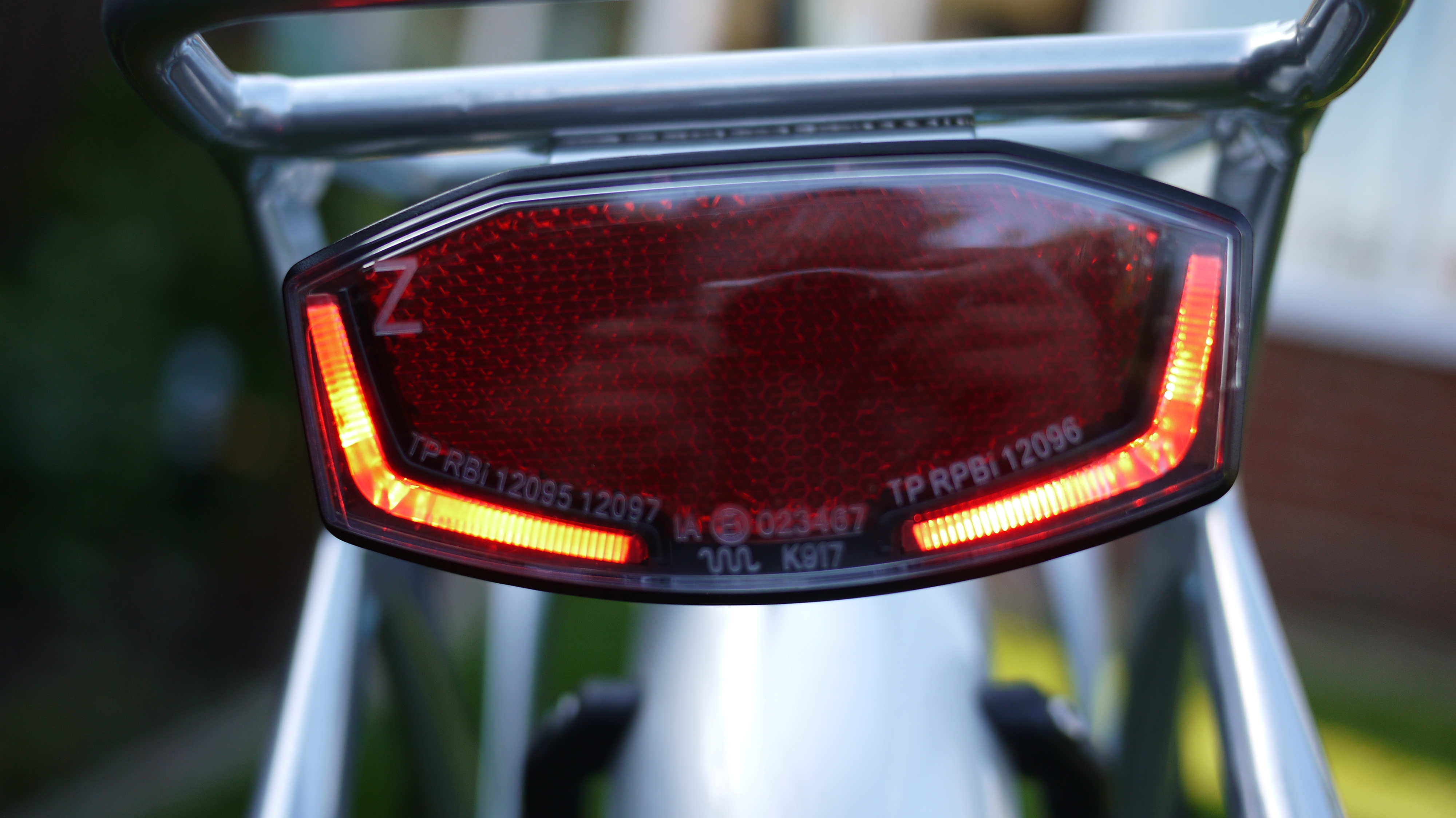

To keep your skirt/trousers free of dirt and oil, there is a chain guard fitted as well as full-sized mudguards front and rear. To help light your way on the dark winter evenings, front and rear LED lights are powered by the main battery; holding down the + button on the display activates these.  Whilst not ‘super’ bright, they’re good enough for urban environments rather than unlit country roads. There are no modes, they’re a straight ‘on’ or ‘off’. The backlit display also comes on/off at the same time as the lights, with three levels of brightness, accessible via the settings menu on the unit.
