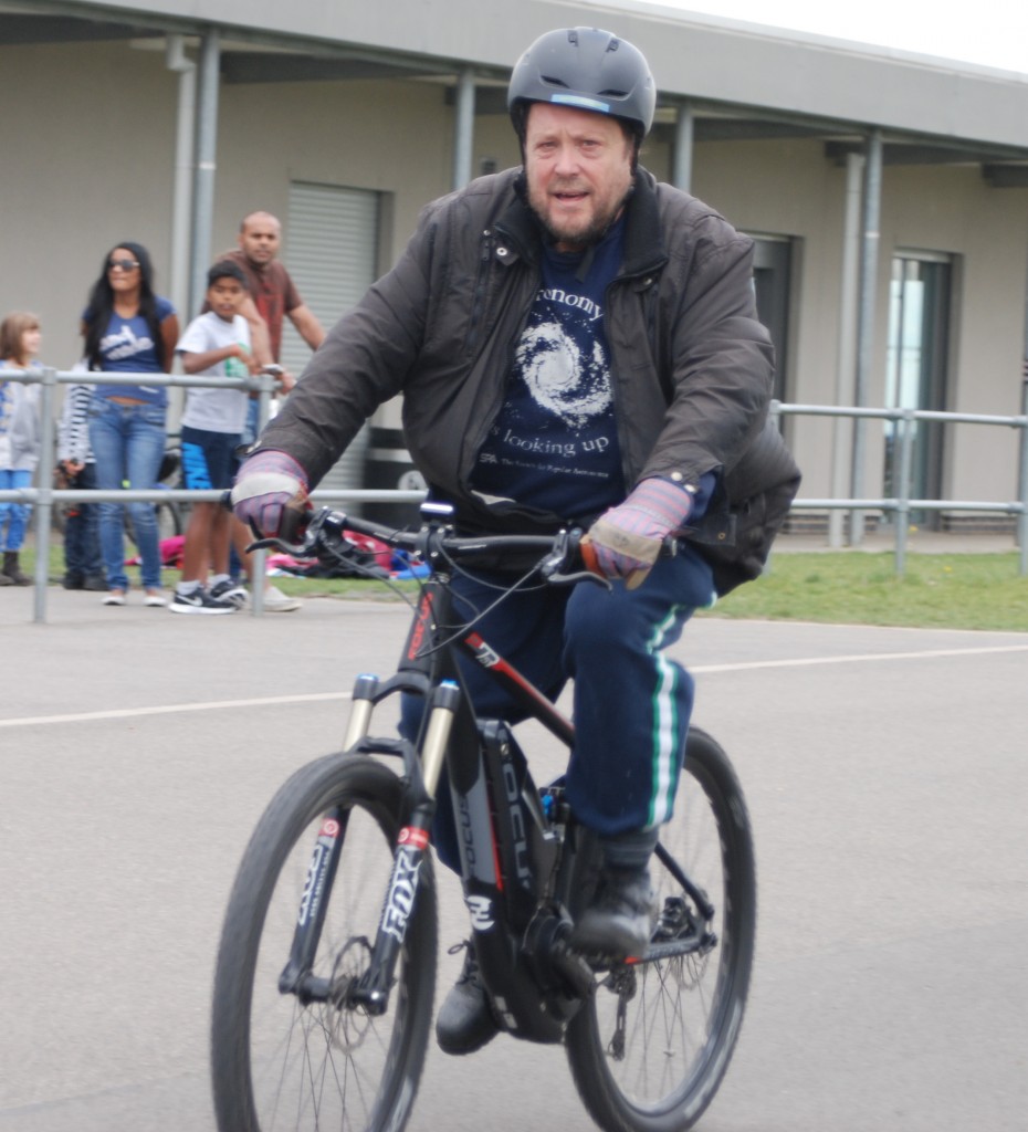

Teejay, “aged 59, retired and uses his Kalkhoff e-bike as his main transport most days”.

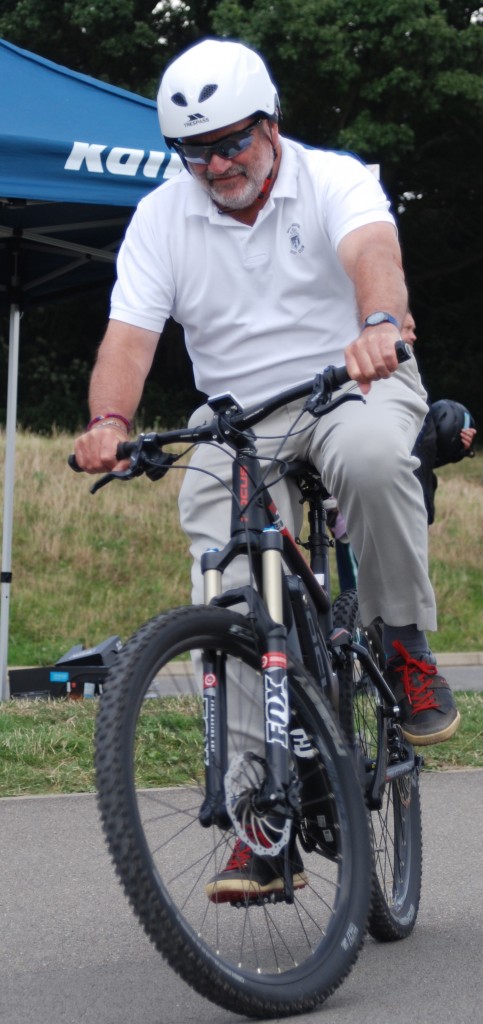

And finally AJB9, “68 year old, retired police officer with two metal hips, slightly arthritic knees, fairly fit”.

Teejay: “Very mountainbike. No guards or rack, shapely downtube battery. Impractical for me, but beautifully finished.”
AJB9: “Looks very nice and well put together.”

Teejay:  “General points – Once I was shown how to change the power setting, easily the most powerful of the 3 I test rode that day. A true torque sensor made it the most natural to ride – but that’s what I prefer anyway. Steering and handling: fine, it just got on with what you asked it to do. I found the hill-climbing ability of the bike excellent. In high power – and giving it a bit of welly – it rocketed up the hill. Smooth and powerful acceleration; with cruising you have to pedal but for me I found it to be speedy and effortless.The braking is powerful and very controllable. With the gear changing – there was no sense of the power going through the transmission. All changes were spot on. The controls were fine once I got the hang of them. I did like the uncluttered handlebars and simple LCD display. However the handlebars were a bit wide for my taste. Its best feature is the torque sensor with a powerful, torquey motor.
AJB9: “The saddle was made for the Tour de France, not an e-bike. Smooth ride. Controls worked well. Handle bars I feel are a bit wide though. The handling was good, with a smooth, fast ride. The acceleration is very good if you pedal hard. The brakes were firm and very smooth, stopping the bike with ease. Changing gears is easy and I thought the controls are well laid out and easy to use too. The bike’s best feature are its ‘bad boy’ looks.”
