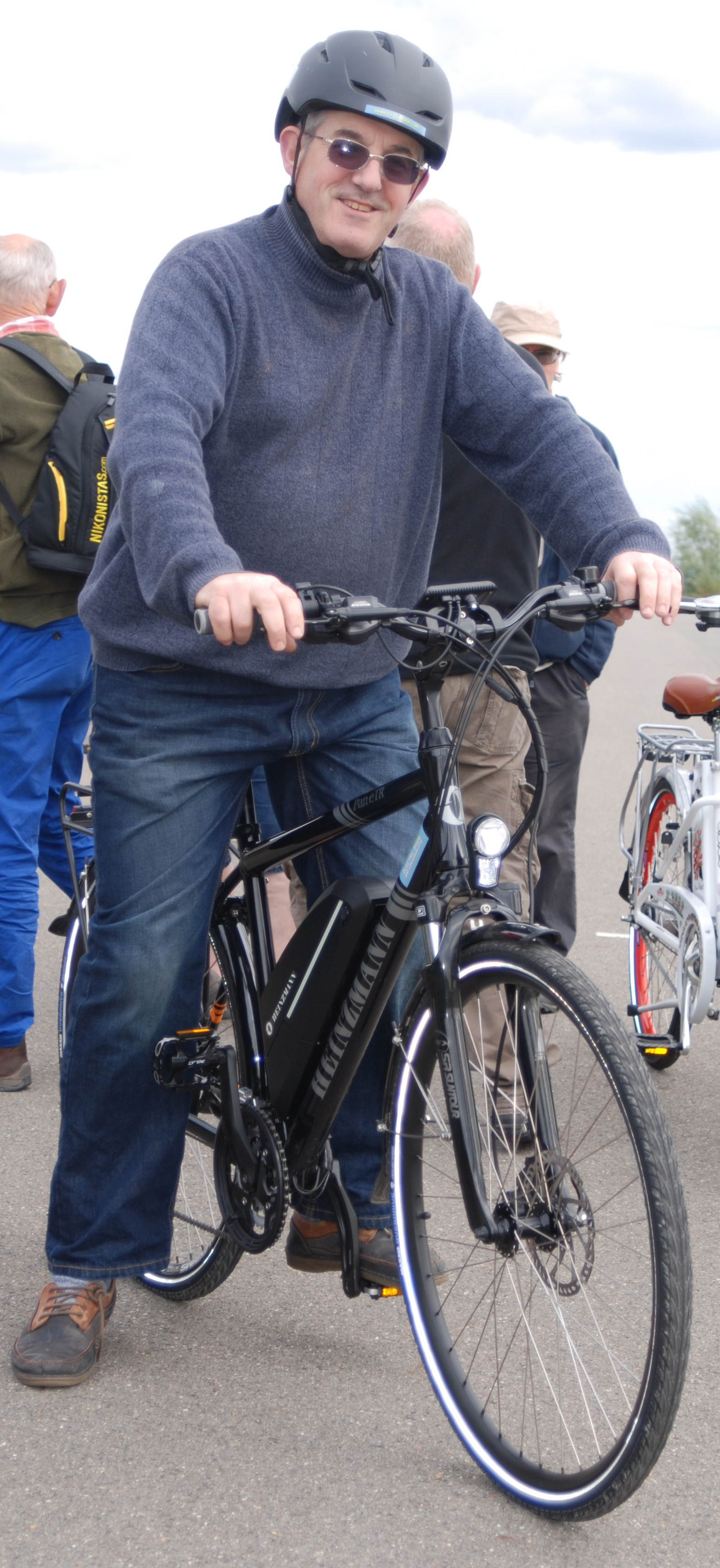

First impressions – how does the bike look?
D8veh: “Looks nice and purposeful.”
Saneagle: “Not my ideal looking bike, but for some it would be fine.”
Teejay: “Neat and understated. Nice to see a bike with mudguards, lights and rack, making it practical.”
AJB9: “Good looking bike with the controls well laid out and easy to use.”
Overall group star rating for aesthetics: 4.25/5
DSC_0692b
What do you think of the build quality?
D8veh: “Looks excellent; only the mudguard stays look a bit out.”
Saneagle: “First impressions: looks OK.”
Teejay: “Excellent. Very neat welding on the frame. Shame the bell had broken!”
AJB9: “Very good, brakes worked well on the test ride and gear changing was easy and smooth.”
Overall group star rating for build quality: 4.5/5
How did it ride?
D8veh: “Very smooth, comfortable and neutral. The steering and general handling of the bike was perfect. Accelation scored a medium from me, but was smooth. However the cruising was fast and comfortable with excellent braking. I can’t fault changing gears, or ease of operating the controls – both excellent. I’d therefore say the best feature of the bike is relaxed, high-speed cruising.”
Saneagle: “The only issue for me was the steering was too light, I did not feel too safe going around bends. That said it tackled hills OK, the acceleration was fine and the cruising was good – particularly because the type of tyres on the bike meant it rolled excellently – I was impressed with that. Braking, changing gears and ease of controls – all good. The bike’s best features I would say are the ease of rolling and the digital display.”
Teejay: “Fairly light for an electric bike, but a feeling of solidity nonetheless. Well balanced. Moved off quite smartly without having to pedal far. The steering and general handling was neutral and unobtrusive – which is very good – like a good suit, unnoticeable. Hill-climbing and acceleration I felt were pretty good and cruising was effortless and comfortable. The braking was powerful and true, although it felt a bit harsh sometimes. Gears – went in every time, no problems there. Controls are good and simple; I liked the LCD display. There wasn’t anything I didn’t like about this bike. Its best feature is the motor – a broad spread of power and almost silent.”
AJB9: “It was a smooth ride and also easy to ride without power. It climbed the hills with ease and the steering was smooth and positive. Acceleration was good and really smooth with comfortable cruising. Braking followed suit with no snatch or jerking. There were a few clunks on changing gears, but maybe that was me. I did find the controls very easy to operate. Overall, I’d say the bike looks well-made and I liked the well laid out controls.”
Overall group star rating for the test ride: 4.25/5
