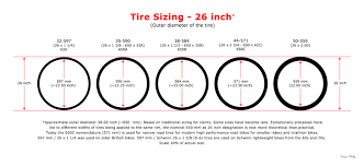

As you may know, there are many different types of 26" wheel size. We would like to do a survey to find out which type of 26" wheel is most common so that we can offer the right wheel sizes for eBike conversions
We sell 650C 26" wheel size (571mm rim diameter)
- 650 (597mm)
- 650A (590mm)
- 650B (584mm)
- 26X2 (559mm)
More details in below image
Please vote to let us know which 26" wheel size you think is most common and that we should sell. You can select two sizes if you think there are two that are equally important.
