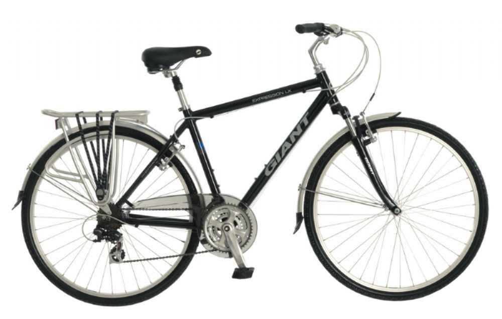

Anyway looking around again I've seen a Giant Expression LX commuter/comfort bike going cheap as well, photo below. This is setup for comfort rather than speed, which I know my sore back would appreciate having commuted the past couple of days following a 2 week break.
Any opinions on the suitability of this bike for a conversion..?

Sorry to hear the Giant Roam was a bit on the big side, obviously seat and handlebar heights can adjusted, but not the crossbar. Hopefully, Wiggle will take it back without too much hassle.
The Expression LX would be quite suitable for a 700c front or rear wheel eZee conversion.

The Expression LX commuter looks OK to convert Phil. It's a 28" right? You just need to check the distance between the drop-outs.

Yes it's a 28" wheel Bob. While I prefer disc brakes it ticks most other boxes and makes the fitting of a brake cut-off switch easier. I'll try and find some specs online for drop-out clearances if/before I buy it, maybe on fork manufacturers website, its an RST SOFI 50mm.

If you haven't already checked Phil, the fork specs are here RST all that is apart from the one you need, dropout width .
You could ask the bike supplier to measure them for you. My guess is they will be 100mm, but better to be safe than sorry.
