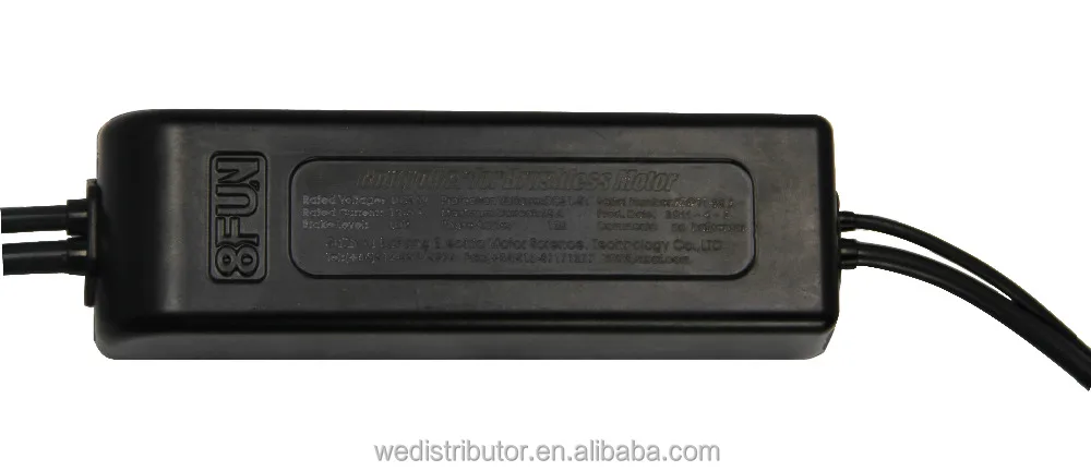

Yes the fiece vibration you describe is exactly what happens.
There is only one connection coming from the motor, it is the same as in the image shown below:
There are no other visible connectors between motor and controller. I have not tried opening up the controller, but it looks similar to this one below:
Hope this helps.
Deleted member 4366
There can either be one or two connectors like that between the controller and the motor, so check that it/they are fully in to the guide-line.
If that doesn't fix it, look very carefully where the wire comes out of the axle to see if there's any damage in that area.
After that, it's most likely a controller issue that could be anything like a bad solder joint, faulty mosfet or faulty capacitor. You'd have to open it up to check or test what's wrong.
