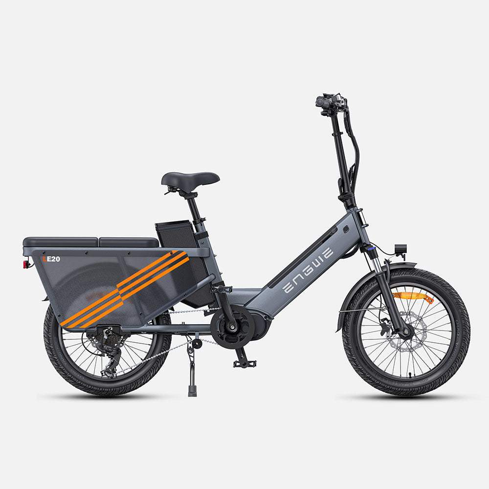

Cheaper alternative ?
8,882
3,982
The Engwe LE20 will be perfect for what you want. It has a very powerful 48v motor and is adaptable for carrying all sorts of loads including kids. It's also pretty cheap and very good value at only £1250.
Kid cage is extra if you need it:
Look how happy they are:
In this case, fails the local dealer test.
More generally, the sticking point is until you ride it, after purchase, there is no way to know if it will do the job. Yes, 60Nm hub motor, but if the rider can't keep it above the 'bogging down' speed, it won't, and you run the risk of heavily laden bike with small child on a hill you can't get up. The tiny cassette limits the ability of the rider to help the motor.
It might be great! Perhaps one of our wealthier contributors could buy one and review it!
A few spec issues I don't like too: fat tyres waste energy, and fat tyres as well as suspension fork? Don't need both. And those bespoke wheels... why?
Edit: but on the upside.... massive battery, frame design looks sound, some of the options are included in the base price just now. It's a £1363 gamble, that might pay off.
