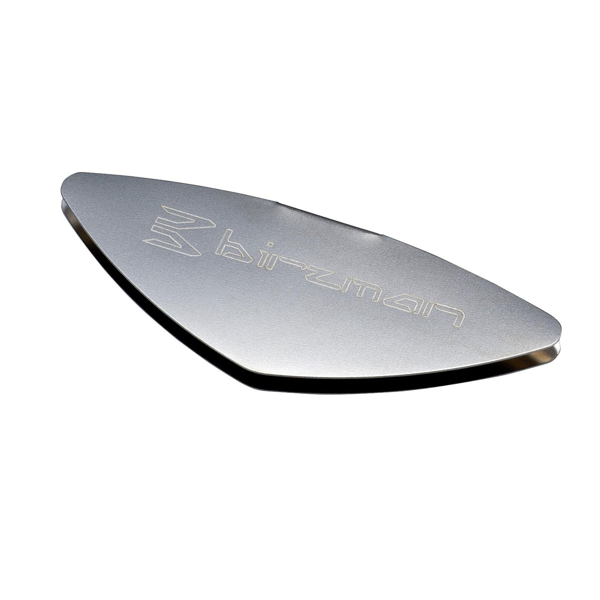

I initially center my caliper using playing cards. Although you can buy a little tool for doing that(like a feeler gauge) playing cards work just as wel as they are the same thickness.
So say you put 3 on each side. and the last card goes in tight, or 4 or however many, this means the caliper body is totally central, and you arent relying on the pistons to work exactly the same.
Should say though my brakes are the high end type, so the pistons move equally, although like the vid i do have to tune them very slightly when i remove the pads to clean and lube the pistons.
On lower end systems you cant really rely on them so work perfectly, so best i think to centralize the system using mechanical means- an alignment tool or in the case of this frugal Scotsman, a pack of cards.
Wee tool thingy - there are different makes, but cost no more than a tenner and are i believe handy to have to save a bit of faff.
