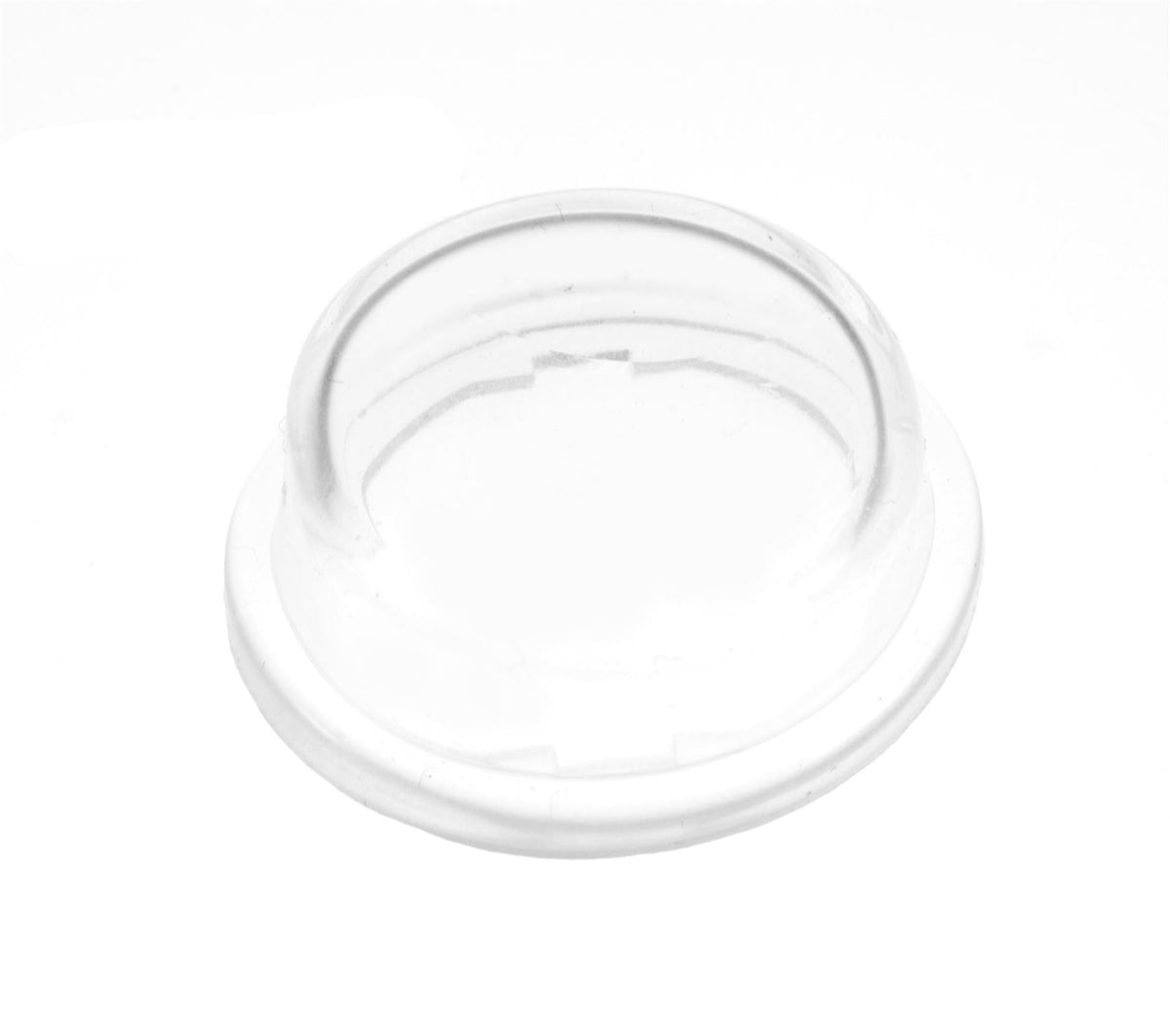

What I have yet to do is figure out how to 'waterproof' the battery on/off switch which is just a cheap rocker switch. At the moment I just stick tape over it if I suspect I might be out in the rain.
My battery also has a round rocker switch - before opting to use two waterproof rucksack covers to protect both battery and mount, I found this silicone cover for rocker switches, which might be easy to fit? (If your rocker switch isn't glued in. If they've used hot glue, maybe soften with a hot air gun?)
Also available on ebay (with purchase of a £2.30 rocker switch)
Reactions: Bikes4two
11,870
3,344
@Bikes4two - I was going to fit one of those silicone covers, but the rocker switch on my battery was secured by rather a lot of hot glue. At the time, I didn't have a hot air gun... plus it looked like a messy job which could have required soldering in a new rocker switch, and at the time I had no soldering skills. Simply covering the battery was a easy, fast and effective solution - at a quick glance (which is all observers will have time for) also obscures the fact that I'm riding a electric bike, which is better when riding through certain neighbourhoods. The top waterproof cover on my rear rack mounted battery is hi-viz.
