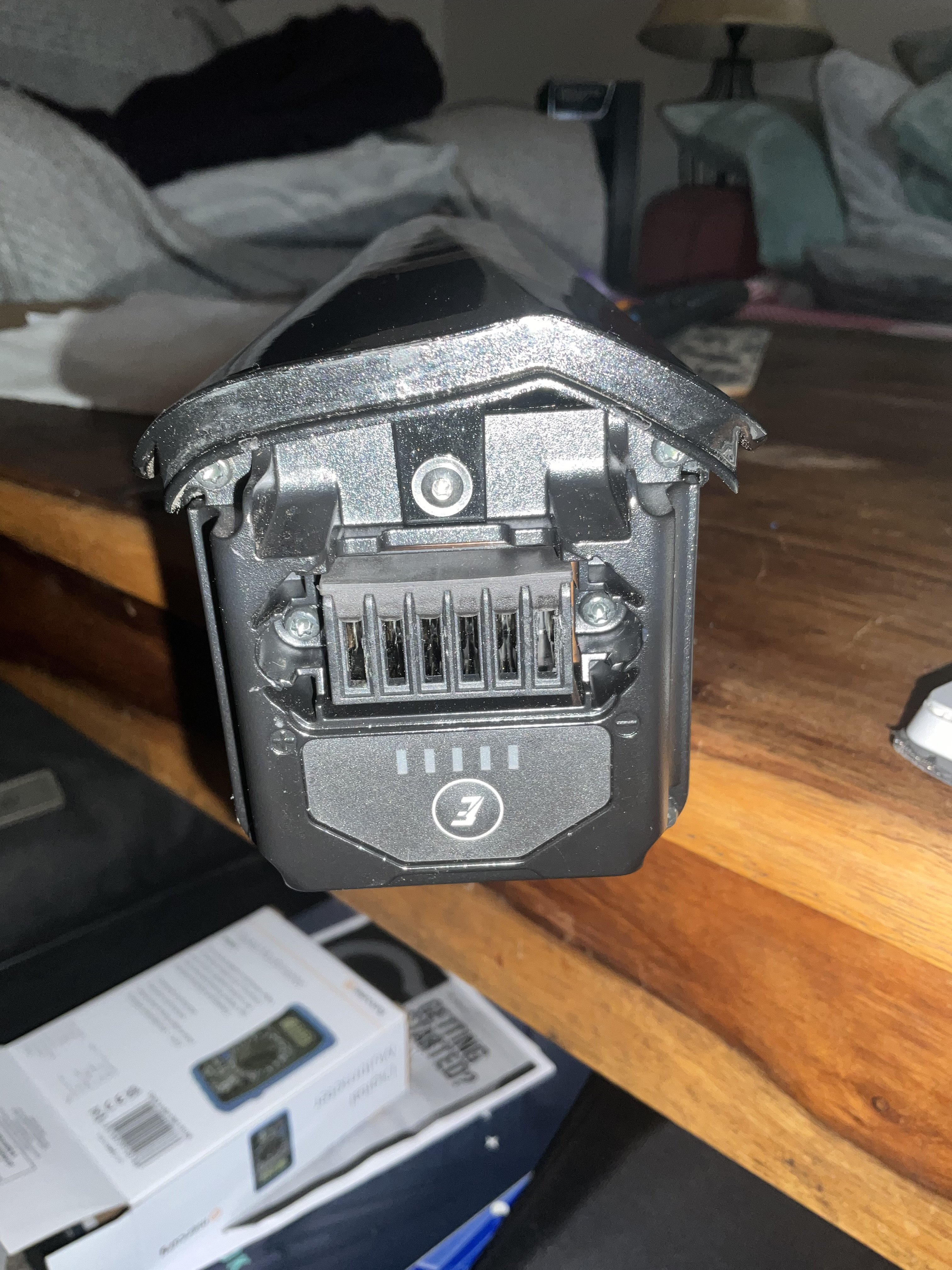

Ian Smith
Jul 7, 2015
6
64
Hi Guys
Thanks for your help, I have tried cleaning and resetting the pas sensor as per your suggestions but still not working, can anyone tell me where I can get a like for like replacement as per attached pictures ? I have tried contacting Kudos but once again - no reply (6 e-mails)
