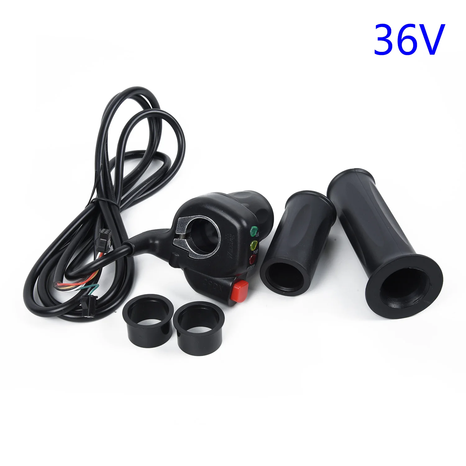

Well after many tries think the problem is with the throttle on the handlebars took it apart and the little magnet sensor dropped off and there was a wire floating around not sure from where. The upshot is that when I put it back together the throttle didn’t work but the pedal sensors did so at least I can use the bike. Anyone any ideas on where I could buy a new throttle? Looks like there are 6 wires.

That style of Wuxing throttle isn't used much anymore. This matches the one you have, but the connectors may not match, so some cutting /soldering/joining may be required.
This one looks like it prob. has the same connectors as yours.
You can check your connectors on the controller. You could use any 3 wire throttle.

You can use any throttle you want because they all work the same. You can buy one that looks identical to the Cyclamatic one, but it will have different wiring. IIRC, the switch on the Cyclamatic's throttle is wired internally to switch off the 5v to both the throttle and the pedal sensor. That's why the pedal sensor's 5v wire comes from the throttle instead of the controller.
In other words, whichever throttle you get, you will have to do some wiring.
You should replace the throttle with one that has some sort of battery indication. You can get one with a switch as well, but you can also use a separate switch.
Tell us which one you choose, and we will be able to tell you how to wire it.

Looking again maybe wheeliepetes 1st suggestion is best does the voltage matter my bike is made for a 24v but I have been using a 36v battery for over a year with no problems

If you want to use the battery indicator LEDs, you must choose a 36v throttle. As I said, that throttle looks the same and fits the same, but it's different inside and has different connectors.

Tbh would rather the wires fitted and the twist grip worked not too bothered about the battery lights
So that probably means the 24v?

If you have a 36v battery, you get a 36v throttle. If you have a 24v battery, you bet a 24v one. The only difference is when the LEDs go out.
As I already said, the wires won't be the same on any throttle because the Cyclamatic has special wiring. Only a genuine Cyclamatic one will be the same. Look at the connectors in the picture above. You can see that they're different. Whichever throttle you get, you'll have to do some wiring.
