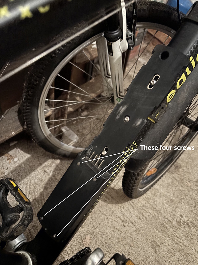

Yeah, just undo these 4 screws and take a pic.
You can buy these for $12 from Topbikekit, there is no controller under the cover, just two wires coming out for connecting to a controller:
You can specify whatever connections you like, if you buy the controller from them, you can tell them you want them both XT60 (for example).
No soldering required.
But first, always listen to saneagle, best check the connection to the motor is 9 pin.

Let's make it simple. Before anything check the motor connector. Next, do what Waspy said: Take off the battery, remove those 4 screws, lift up the end of the black plastic and wiggle the aluminium base out along with the connector. You might have to remove the bottom scre that holds the base to the frame to get a bit more wiggle room - possibly loosen the middle screw too, but your one might have a slightly different fixing arrangement.
Unfortunately, you need an empty aluminium piece to use an alternative base. That means that you have to either buy a replacement base of exactly the same type or scrape out the old controller from the aluminium piece. Sorry, I forgot about that. The one I just did had a defective controller, so I scraped it out.

Great, thanks: I'll have a look at this in the morning.
Thanks. I'll have a go at this in the morning.

OK, I managed to get at the controller and take a pic:
64380
I can't see anything obviously wrong with the controller – but then, other than clearly broken connections, I don't really know what I'm looking for.
