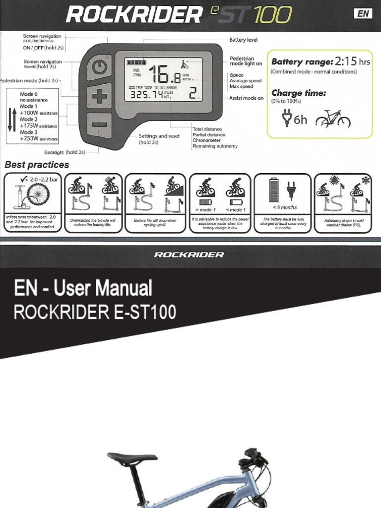

e-ST100 Rockrider
Zarjaz
Jun 22, 2020
5
1
After a 4 week wait, I've just picked up my new e-ST100. I didn't receive any manuals with it. I've found online manuals for many other Decathlon pedelecs, but not the e-ST100 - not in English anyway!
Does anyone know where I can find the mechanical and electronic manuals?
gsm.terra
Aug 3, 2020
157
79
Edinburgh
I could only find Spanish manuals, although the e-st 500 is similar, only difference I can see is that your bike has a cadence sensor as opposed to torque sensor on the 500? I hope this is of help!
akcapped
Just Joined
Nov 22, 2020
1
2
After a 4 week wait, I've just picked up my new e-ST100. I didn't receive any manuals with it. I've found online manuals for many other Decathlon pedelecs, but not the e-ST100 - not in English anyway!
Does anyone know where I can find the mechanical and electronic manuals?
You can find the Owner's/Users Manual here, in English:
It's worth noting that Decathlon does not make the English Users Manual available. There must be a good reason, but it's frustrating.
After searching for weeks, and contacting Decathlon, only to get no help or the wrong manuals, I translated the Users Manual into English, cross-checking against the manuals in German, French and Italian (my wife is French, I speak German, and we live in Italy).
The above linked file also includes the Quick Start Page -- its only a single page, but is pretty handy.
The file also contains the full specifications for the bike, as well as photos.
Sribd.com is a pretty good host for things like this. The file is available for download; they may ask you to upload a useful document in order to be able to download this manual.
PCM
vfr400
Jun 12, 2011
9,822
3,985
Basildon
You can find the Owner's/Users Manual here, in English:
It's worth noting that Decathlon does not make the English Users Manual available. There must be a good reason, but it's frustrating.
After searching for weeks, and contacting Decathlon, only to get no help or the wrong manuals, I translated the Users Manual into English, cross-checking against the manuals in German, French and Italian (my wife is French, I speak German, and we live in Italy).
The above linked file also includes the Quick Start Page -- its only a single page, but is pretty handy.
The file also contains the full specifications for the bike, as well as photos.
Sribd.com is a pretty good host for things like this. The file is available for download; they may ask you to upload a useful document in order to be able to download this manual.
PCM
It's against the law in the UK for any dealer to sell an electric bike without a user manual covering these things. If you get a bike without a manual, you should demand that the dealer provide it and point out their obligations under EN15194:
a) preparation for riding — how to measure and adjust the saddle height and handlebar height to suit the rider, with an explanation of the insertion-depth warning marks on the seat-pillar and the handlebar-stem, and clear information on which levers operate the front brake and which lever operates the rear brake;
b) recommended tightening of fasteners related to handlebar, handlebar-stem, saddle and seatpillar, and wheels;
c) the method for determining the correct adjustment of wheel quick-release mechanisms, such as, “the mechanism should emboss the fork ends when closed to the locked position”;
d) the correct assembly of any parts supplied unassembled;
e) the permissible total weight of the rider and luggage;
f) lubrication — where and how often to lubricate, and recommended lubricant;
g) the correct chain tension and how to adjust this;
h) adjustment of gears;
i) adjustment of brakes and recommendations for replacement of the friction components;
j) care of the wheel-rims and a clear explanation of any danger of rim-wear;
k) appropriate spares, i.e. tyres, tubes, brake friction components;
l) accessories — where these are offered as fitted, details should be included such as operation, maintenance required (if any) and relevant spares (e. g. light-bulbs);
m) safe riding — regular checks on brakes, tyres, steering, caution concerning possible increased braking distance in wet weather;
n) the type of use for which the bicycle has been designed (i. e. the type of terrain for which it is suitable) with a warning against the hazards of incorrect use;
o) an advisory note to draw attention to the rider concerning possible national legal requirements when the bicycle is to be ridden on public roads (e.g. lightning and reflectors);
p) the importance of using genuine replacement parts for safety-critical components.
q) Concept and description of electric assistance;
r) Recommendation for washing;
s) Control and tell tales;
t) Specific EPAC recommendations for use;
u) Specific EPAC warnings;
v) Recommendations about battery charging and charger use as well use as well as the importance of following the instruction contained on the label of the battery charger.
Reactions: gsm.terra
Zarjaz
Jun 22, 2020
5
1
Against the law or not, this is what Decathlon do.
Many thanks to PCM, above, for taking time to translate other the German/French/Italian manuals into English. This is very, very helpful! :)
Reactions: gsm.terra
