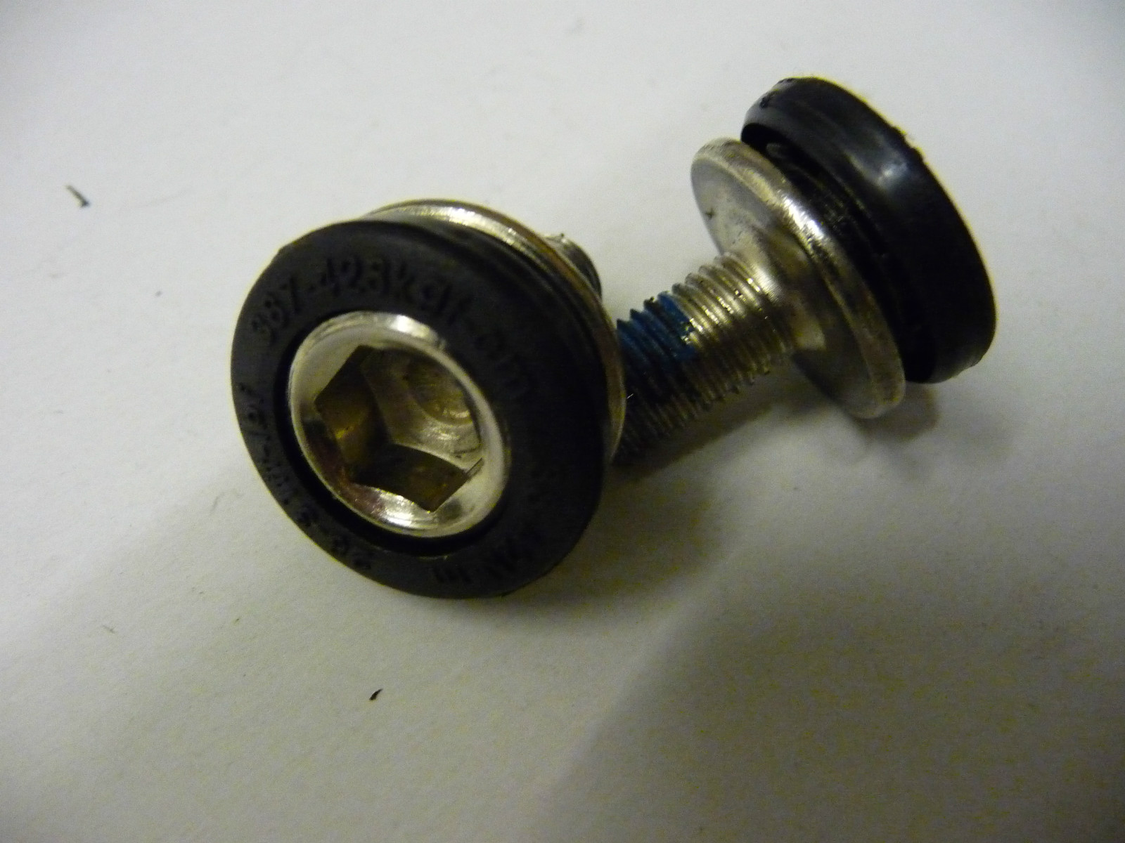

first, you need to check that the crank bolts are tight.
For this, you need a long handle 8mm allen key like this one
Tighten each bolt about half a turn to see if the click changes.
the torque setting for these two bolts is 40NM-50NM, quite high. The bolts also has to have some medium strength blue loctite to stop them getting loosened.
pedelecvirgin

New wrench bought, blue loctite bought, bolts removed cleaned, blue loctite applied as per instructions, tightened to 45 Nm. No difference whatsoever.
