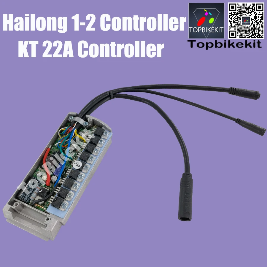

I’ve had good results using this battery base controller with a 36v q128c
US $59.60 | KT sine wave controller 36V 500W 48V 500W Hailong controller Big Hailong battery case controller 36V / 48V 22A 9 mosfers
I run this controller displayless

36v, but the motor is wound for the highest rpm, and laced into a 700 wheel. The controller has PAS and throttle connections.
