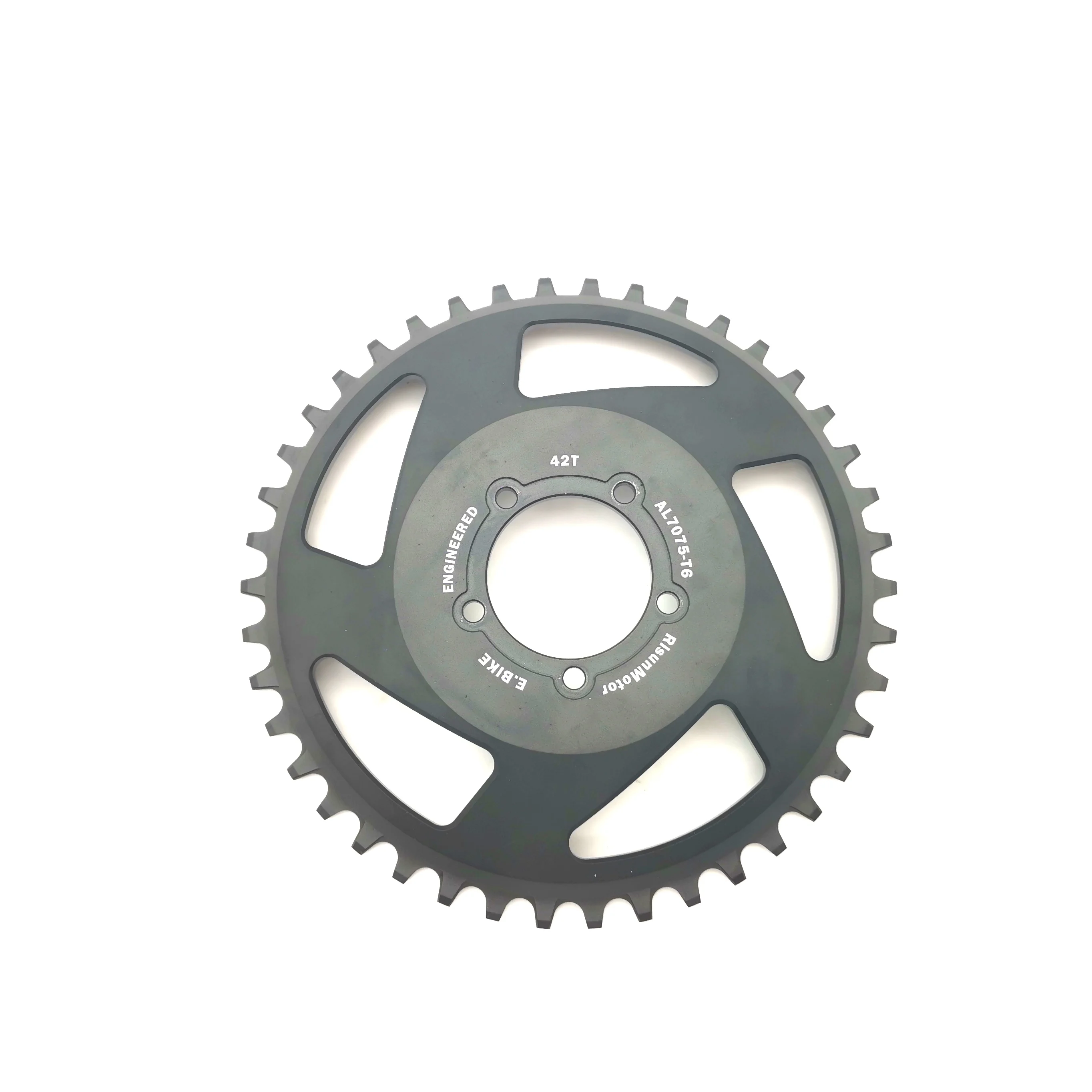

Hi all
In the quest to improve the chainline and to give a lower gearing compared to the stock Bafang 44t chainring, I have been looking for a cheaper alternative than shelling out £70+ on a Lekkie Bling Ring and found this on Aliexpress for £31 delivered inc VAT
Have took a punt and ordered one, Will update with review and pics when it arrives

Coincidentally, I'm thinking of buying the 60T version to go faster on the flats (unpowered by the motor), so I'd love to hear abut how you get on:
How robust are these aluminium alloy chainwheels? They're not much of a monetary gamble at that price, but potentially distressing if they warp!

Looks OK and as long as it is properly heat treated, should do the job.

Long time, forgot to update this thread with info about this chainwheel....received in just under 2 weeks from China. Easy to fit, works well, well made. Note : the price has crept up to about £39 delivered now but you may have a discount coupon and cashback (topcashback etc) to bring the price down...One thing to note it does fit very close to the the plastic main drive cover (see pics)
I estimate it brings in the chainline about 3-4mm (improved offset) closer inwards compared to the stock 44t Bafang chainwheel
It weighs in at 178g compared to the stock steel 44t bafang chainring at 273 (not including plastic chain guard)
anyway, here's some pics
