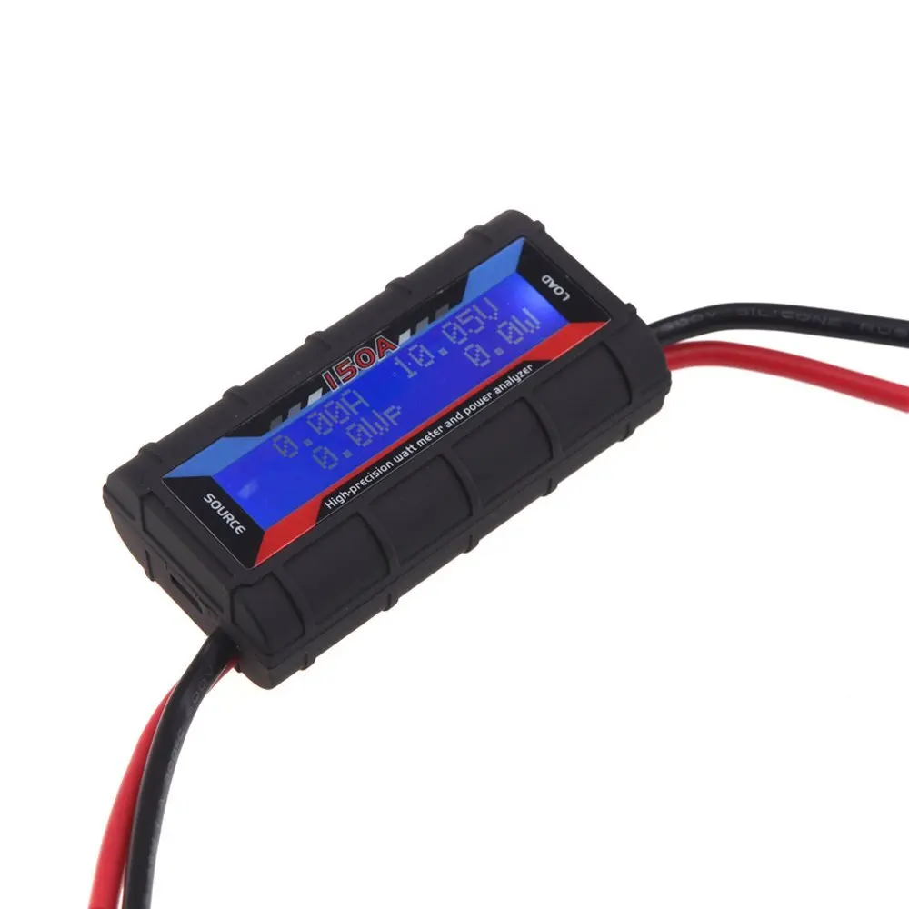

I have one similar to this
Shows:
- Watts Peak
- Amps peak
- mAh used
- Wh used
As well as battery voltage, running time and real time Amps and Watts

I assume that the Lidl power meter plugs into the mains?
The battery charger will be working at roughly 85% efficiency (15% lost as heat) - that gives you an idea of how much power is actually going into the battery.
Anotherkiwi's type of meter is much more accurate, but probably over the top unless you are trying to fine tune the system.

I like theTenergy meters that anotherkiwi posted. Not really over the top, as they only cost $10USD and a 5 week wait on ebay.
Since my ebikes have connectors on the battery cable, I used it to assess my battery usage. I've also put it between my charger and the battery. I've always found that the power used during riding is about the same as the power needed to recharge.I'd estimate the accuracy no worse than 5%. I've put two meters in series and the amp readings are identical although volts an be 0.5 volts apart at 42V..
