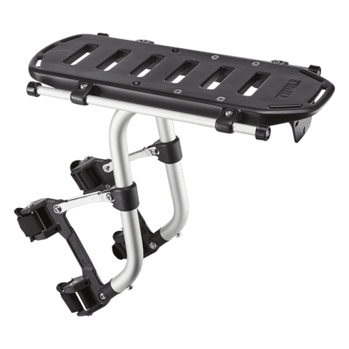

Just got hold of one of these and am very pleased so far. Thanks for the information on the password, it worked like a charm. However, my problem is that I can't find a way to secure a pannier rack. The local bike shop have suggested a seat mounted rack, but has anyone got a suggestion that would carry a bit more weight? I did email Merlin who suggested a variety of "normal" Torpec racks, but these aren't compatible according to my local shop.

If the bike has no tapped holes for a rack, then have a look at the Thule pack n pedal pannier rack. Though not cheap it works very well once fitted correctly. With the side rack kit (optional ) one can fit QR saddle bags like the Ortlieb or the China copy Rhinowalk QR panniers.
I use a Thule on my Cotic Roadrat and carry 3 x 10 ltr (heavy ) cat litter , one on top and one each in the panniers, I have carried 4 x 10 ltr but the handling was bit sketchy.
The rack literally sits on the rear triangle upper stays and uses ratchet binders ( 1 pair each side ), three different length brace bars allow one to fit the rack to sit horizontally and one should be able to sit the rack as low as possible for better handling .
Well worth a look despite the cost.

I was using a Thule Pack 'n' pedal rack on the full suss ebike.
That comes with a range of parts to adjust the angle as seatstays come in different angles
The only downside i found with it, and something possibly you should note on other racks, is the bars the panniers hang on are a bit thick, which required me to adapt the pannier hooks/hangers.
I also zip tied the pannier on, just for permanency and security reasons

My Rhinowalk panniers came with three different diameter size inserts for QR clips to allow fitting to the bars .
In the end I got a bit fed up with the inserts as they would dislodge , I solved the issue by buying some nylon tube/bushes with the correct inner bore for the bars (permanent fixture) and outer diameter for the QR to clip over.
