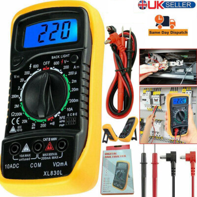

Do you have a meter to test it with?
what sort of meter pal i have disconnected the lights pedal assist and brakes connector from the controller then when i connected the motor it made a thud and jolted a little bit but knocked the whole power of
A digital multi-meter, like this. Without one, you've got virtually no chance of sortin your bike:
gazza19
Aug 22, 2020
216
6
hi yea i do have one of them pal so if you could guide me on what to do would be a great help like i said on last post i disconnected the brakes light and pedal assist and it still did which leads me to think that it is either the motor for sure or the controller
