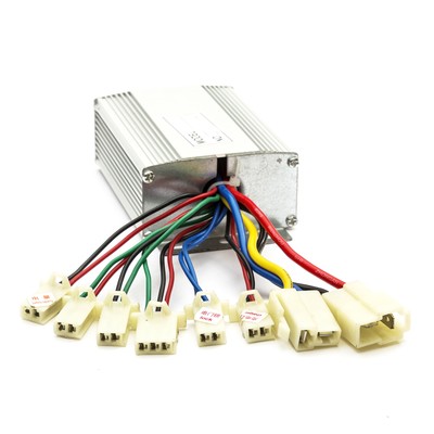

That is, technically speaking, the keyboard and LCD display.
The controller will be hidden somewhere and often is a simple, small Aluminium box, with loads of wires.
On the box will/might be the name of the manufacturer and a part number.
But as both "bits" must function together, replacing it and the LCD display is no big deal and not expensive either.....
They look something like this, but for you, you might need a different voltage and power:-
I hope this helps.
