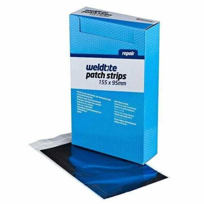

I don't buy kits but buy separate glue, cut to size patch material and any bit of sandpaper to prep the tube area. Instead of buying a larger adhevise tube buy a couple of small ones or a 5 pack. For patch's Weldtite cut to size 6" x 4" repair sheet.
Carry two small tubes in case one goes off.
