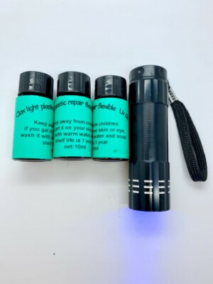

You can repair it with UV glue:
I repaired my glasses with it three months ago after i snapped the side right off. You have to add a fillet to the outside:
40429
Here's a spoke that I broke, then rejoined:
40430
