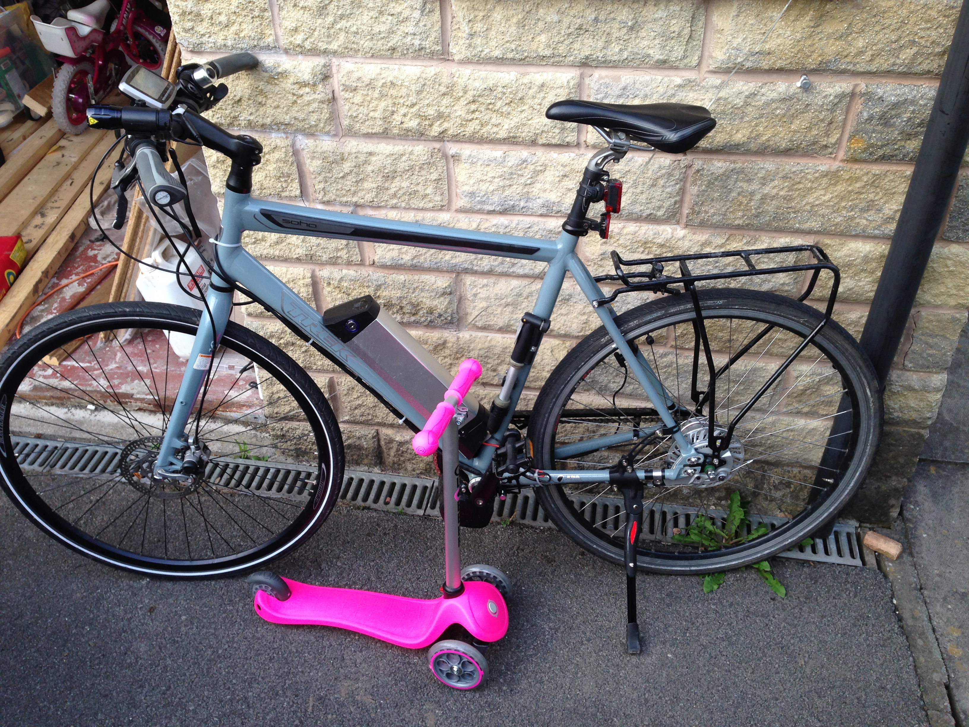

I have just got a new controller,after connecting it up the throttle is not working,it has a cruise wire that works, when connected it runs slowly,there is also a three speed connector coming out of the controller,i have no idea how to connect this up,or if the throttle should work without it.

have you checked with the supplier or manufactures web site for help wiring drawing?
A picture of the controller and output wires would help members to help you.

It is the same controller as ebay item number 191579557572,two of the three throttle wires are reading 4+volts,i thought only one should be live,and wondered if the other should be connected to the 3 speed connector.
