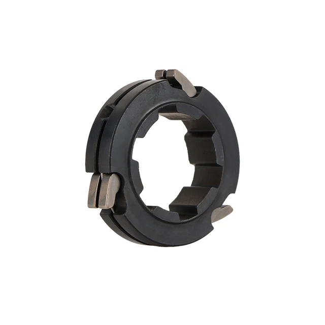

there are two places where the jumping may happen: the freewheel at the rear wheel or the clutch inside the motor.
Wait until you know for sure where the skipping noise comes from. If you want to check the freewheel, ride without power on a low gear up a hill so you can put more pressure on the chain and freewheel.
If you want to listen to the clutch in the motor, ride on throttle up a hill on a middle gear.
Motor clutch:

Thank you for such a quick response! I've just ridden without power and the feeling is not there, although it did make me appreciate the motor! It seems to be at the front, as if the pedal shaft is skipping slightly.
Edit: I've also done the throttle in a middle gear as above, and it does appear to be the clutch. Is this something I can DIY or do I need a new one?
