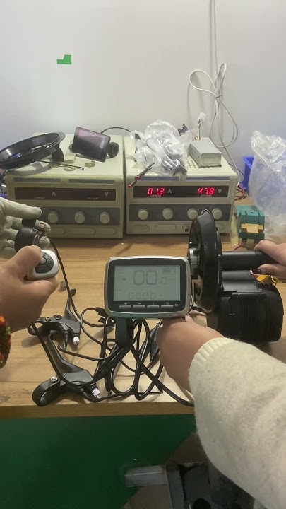

It's a bit of a beast, but a good looking one, complete with throttle and a 250W Tongsheng label to comply with EPAC regulations.
You can leave the throttle kit in the box, your installation will be of course neater.
Gone is the anti-torque hanger on the TSDZ2B.
Powerwise, it is basically comparable to a BBS02B but with a torque sensor, so you don't need to worry about gear sensors and your chain and gears,
The firstb 10 kits to forum members are offered at a special price of £329 instead of the normal price £385.
Prices include DPD next business day delivery.

In this video on throttle, 15A?
I don't know for sure. They arrived 3 weeks ago but I was in France then, just came home for Christmas and back to work today. I will check it out when the weather permits.
Is it 20A controller?
What is the BB width?
The controller is capable of 20A continuous but I don't know if Tongsheng limited it.
The BB width is good for both 68mm and 73mm, similar to Bafang BBSes.
