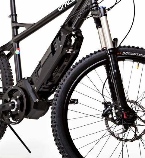

GraceBattery
The heart of any electric bike is the battery; it should be high quality and have at least enough capacity to power your bike for your longest expected round trip.
It is important to remember that the battery not only gives a rider range it also gives the motor sufficient power to propel the bike up hills when the assistance is most needed. The higher the battery Voltage the more power can be sent to the motor. The larger the capacity of a battery (Ah) the longer the battery will operate at its most efficient voltage, giving a rider maximum hill climbing capability.
