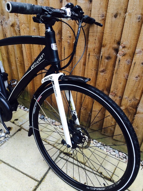

  9. I am selling my Emotion Sport Max as I have purchased a Blue Label Nuvinci Charger. It is in good working order and comes with a 25Ah battery (less than a year old) and fast charger which charges on the bike. It also comes with the standard charger. I haven't done many miles over the last year and have treated this battery very kindly as I only part charge it and never deplete it – only using the middle 60% (this is possible as it is such a huge battery). It has also been treated well, for example not being left in the sun (obviously it shows all five red lights and is still under guarantee) – it should last many years. Also in the last year it has had new mudguards and a rack. This is a well specified, light (20kg), fast electric bike which is very nice to ride. It has Shimano hydraulic brakes and Deore 8 speed derailleur (11-32 with 41 chain wheel). Panasonic motor with standard 9 tooth drive. At the moment is set up as a sporty bike but when I used it I changed it to a more relaxed commuting bike. I can provide the bits to convert it back if that suits you. This is the 50cm frame so it could be described as medium (they didn’t do a small). A new 25Ah battery and fast charger are about £700-800 and I am looking for about £900. The bike is located in North London or it can be collected from Westminster. I can also deliver it to any mainline station in the capital. PM me if you want any more info or images or leave a message here and I will respond.
