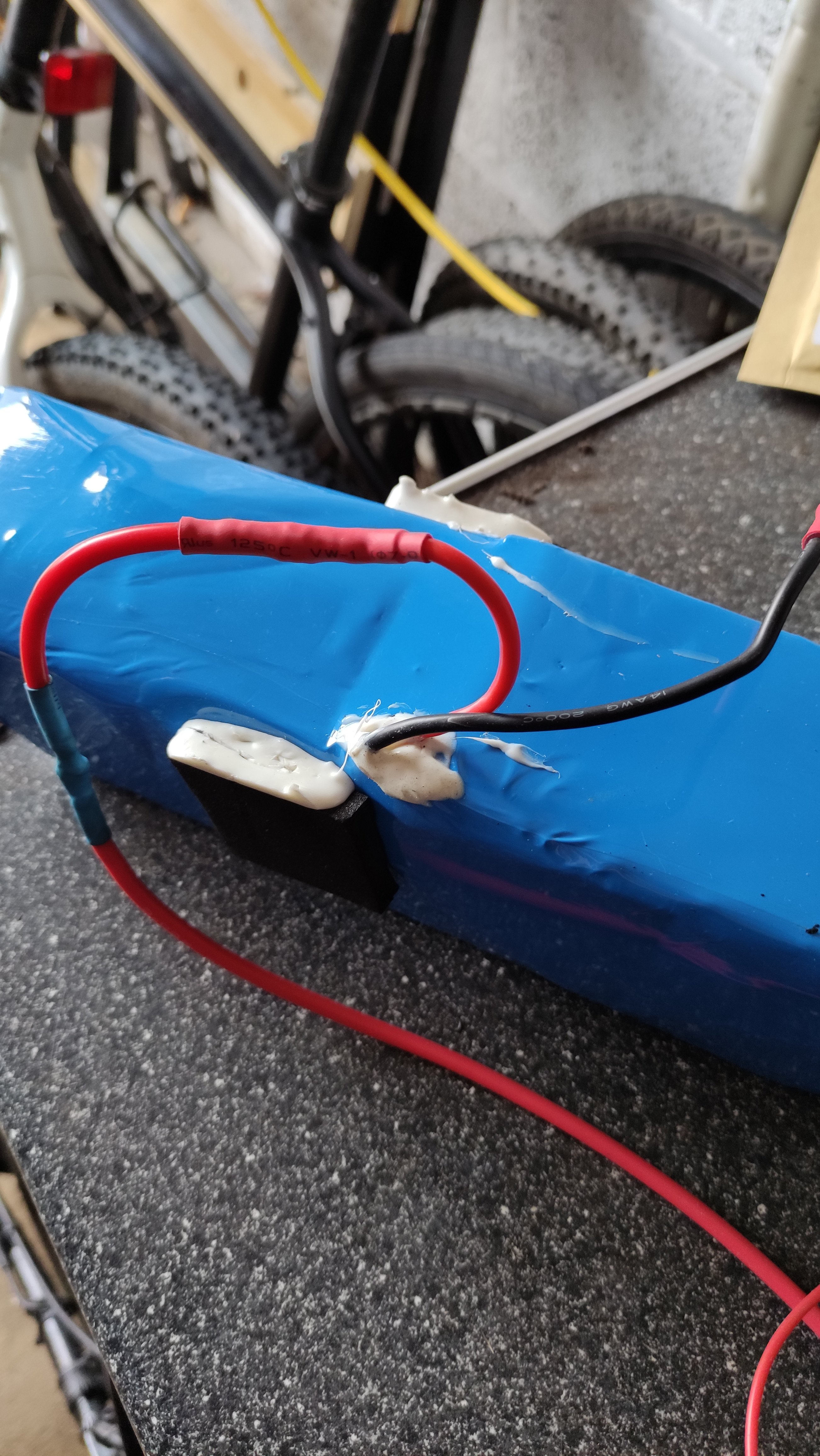

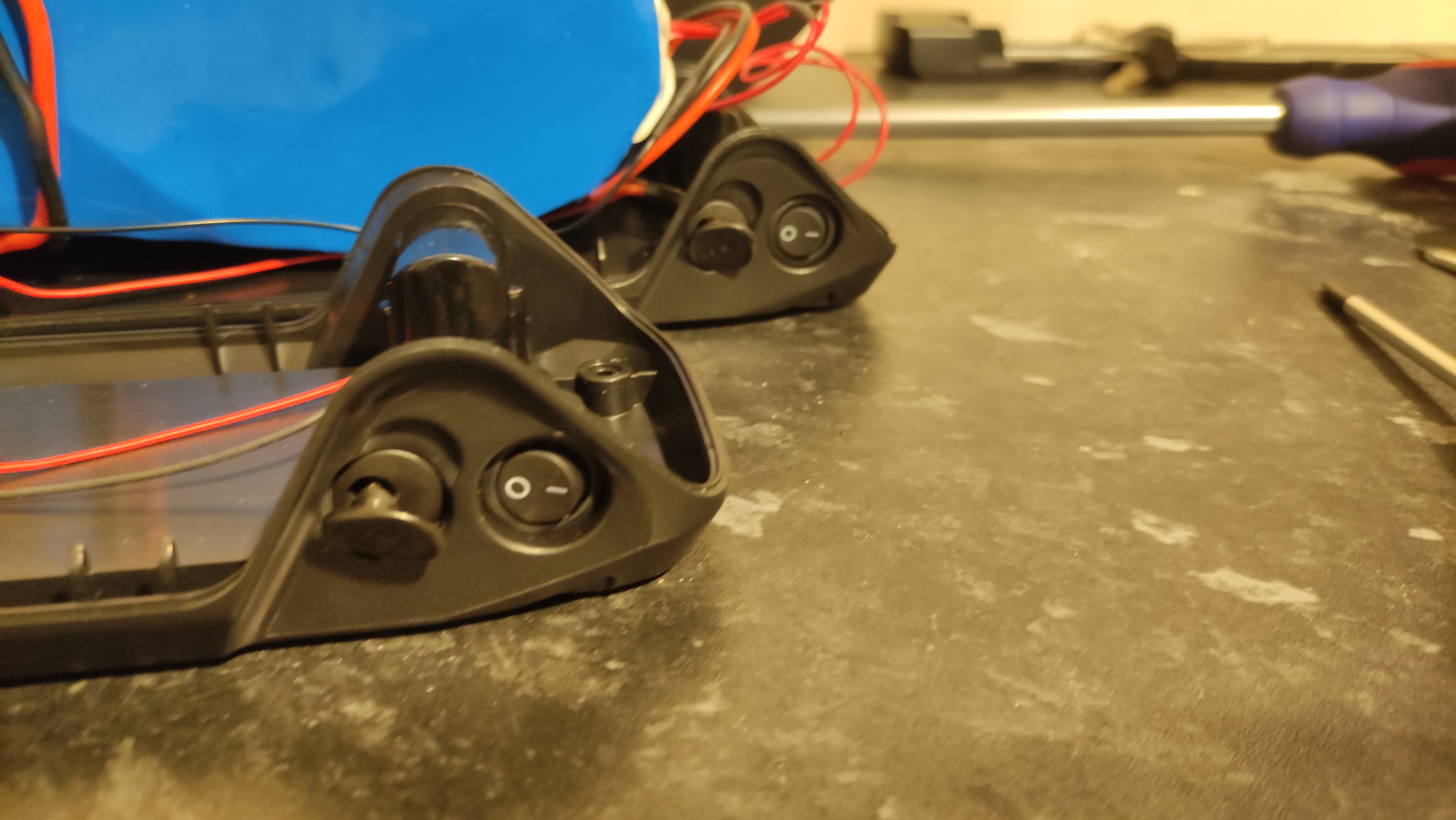

  1. I really appreciate your help [mention=12956]wheeliepete[/mention] . So what is that residual voltage? I have another battery and there is no voltage flowing through it when switched off. Also weird that it is exactly half. Does that also mean when switched off if the PINS connect then it will create the circuit despite being turned off?
  2. Hey Guys I did a post a while back about trying to switch a battery into another case. I thought I would start a new thread as it has been a while and there might be new people who can help. The original post is here Original Post So I need some help before I blow myself up. I removed the wires and copied the design. Most was just like for like, but I have hit a worrying point. I have added some pictures, but I am finding that when I turn off the battery there is still a voltage passing through it. This voltage is half of the full capacity 26V When the battery switch is on then it shows the 52.6V expected. My guess is that it is something related to the charging part. Or maybe the BMS I had to replace the little charger input component with a new (identical one) . Is it possible to solder onto the wrong connectors? Obviously with the power off there should be no voltage so this is not a good situation. I have tried to put some pictures and video here for advice. So here is what I can see 2 main power wires wired into the main pins (this should be OK) 2 small red wires coming from the switch into the battery A medium thickness red and black battery coming from the battery. The black is soldered directly onto one charger point. The red is joined to a small one on the BMS and then soldered onto the other connecter on the charger. A small red and small black wire coming from the BMS. The black goes into the battery pack. The red connects to the wire as above and subsequently joins the charging port. Clearly something needs sorting. Can anyone help

  5. Here are the photos. To me the cases are identical. But the mounts are different. Ideally I want both to fit the mount that is on the bike. I opened the battery to have a little look, but it seemed more complex than I was expecting. Plus the issue is that I still dont have the relevant case, although I do have a second mount.
