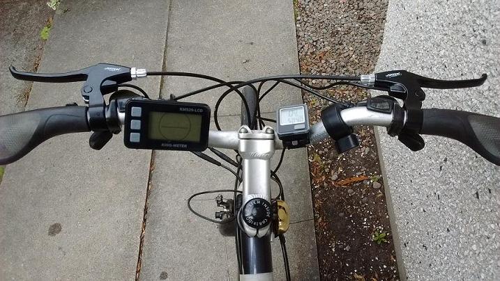

  4. Just as a follow up, after completing just over 600 miles on the above mentioned configuration (24 inch wheel size entered for 700C tandem) I again noticed a pretty large discrepancy between actual speed & that displayed on the KM529. I therefore entered a wheel size of 700C to the menu &, lo & behold, everything now tallies. The speed & hence distance now correlates with reasonably well calibrated other sensors, very strange but also rather satisfying!!

  8. I have recently purchased the XF07 700c front hub kit with 17Ah battery & fitted to a tandem. The first 100 mile is under the belt & I am more than satisfied with the performance of motor hub and battery so far. The only small niggle, & it is small (but if I were following an Audax route it could be annoying) is the discrepancy with the speed & hence odometer. The speed sensor is fitted to the rear seat stay securely & within 5mm of the spoke magnet. The red led on the sensor briefly illuminates on each passage of the magnet & the speed displayed on the KM-529 LCD display is fairly steady (i.e not erratic). With 700c wheel size option entered into the KM-529 the displayed speed is just over 15% in excess of actual speed - i.e 15mph on the KM-529 equals about 12.6mph. I also checked over a fixed 10 mile course and the KM-529 displayed 11.7 miles. I have just entered a 24 inch wheel size option & that has brought the error down to about 2.5%. Unfortunately there is no wheelsize option for 23.4 inch which would see the meter accurate!! Hopefully I am not coming across as a total pedant!!, but it would be interesting to note what associated wheel circumferences are tabulated against specific wheel diameters in the factory settings. Anyhow, I remain very happy overall and the 24 inch wheel size option gives a sufficiently accurate speed/distance for my purposes, although it would be interesting to establish if anyone else encounters a similar discrepancy. Cheers, Simon

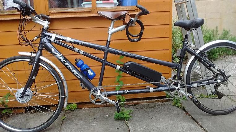

  10. I've had a close look at the disc rotor threaded holes & it looks like they may actually give access to the motor hub internals so I've just ordered a slack handful of M5 grub screws to blank the holes up. The tandem is fairly low geared, think it's a 24 / 30 granny so even on the steepest hill around here I can get a half turn on the crank which should be enough for the PAS to cut in. I can't get the throttle close enough to the bar grips really to facilitate a controlled throttle start, I'll have to practice. But at the end of the day it's no hardship for the wife to jump off if things get too vertical. I actually had to turn the juice off today as the power indicator got a bit low. My fault, I was seeing how far I could go before having to recharge. I think the ODO was reading about 75 miles when I turned it off so that's not too bad - obviously it is all dependent on terrain, all up weight, wind direction etc etc but I'm happy with that as a ball park figure for now (I do however think the speed sensor & hence accumulated distance is reading about 15% high). For interest I was pleasantly surprised that the modified tandem weight is now only 5kg more than it was before, 22.4kg without conversion, 27.6kg after conversion (incl. battery). Anyhow, thanks for the comments, cheers, Simon
  11. Thanks for the response. I can't really see myself using the throttle too much (unless it is to amuse the kids) so will probably try and shroud that in a ziplock bag or something. Basque country a nice place to be based, we used to pull in to Pasajes on the Biscay Coast on a small coaster I used to work one. A beautiful approach from the sea, it looked as though you were heading straight into the cliffs. I'll head back there when all the kids have left home.
