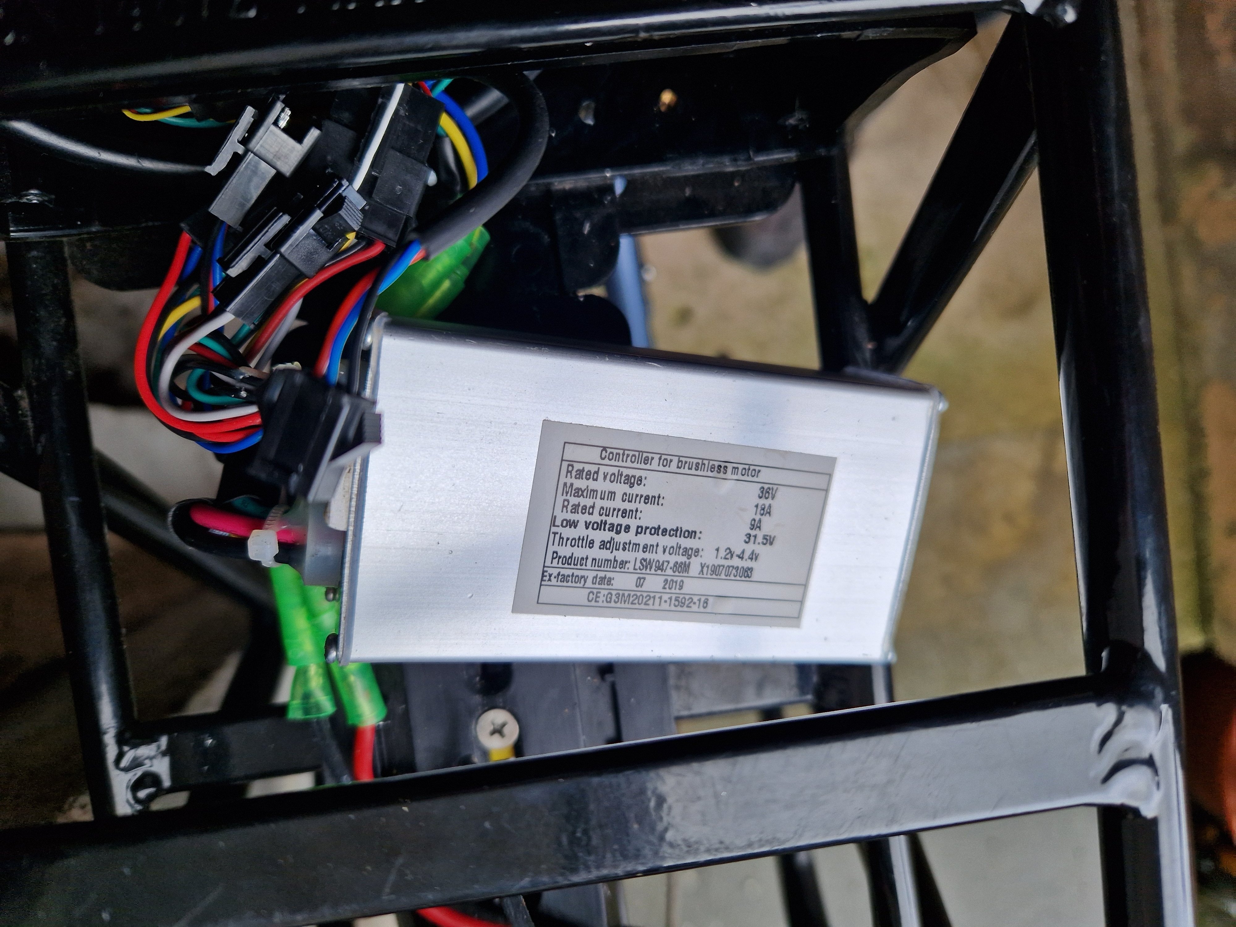

  1. So Mileage is just over 3000 miles. Here's a pic of the Electronic Control Unit, that seemed Globally Unavailable when *advised* it needed replaced. The Fault was actually the small red Hall Sensor pictured, The Cracked Plastic Disc pictured, containing Magnets, was also Replaced. I've ordered another one of each for safe storage and the future.. A Big Consideration Going Forwards, is that Parts like these may become unavailable, potentially making the whole machine useless without expert attention! The Hydraulic Brakes have been Flawless and are still As New. Its still on the original Brake Pads Too. I successfully applied a little loctite (pictured) to the tiny grommet inside both brake lever housings, as it would work its way out over months, meaning lever was getting nearer handlebars under braking. Also the Battery Housing&Rack needed Adjustment to solve a rattle going over bumps, took over an hour of work to reseat rack&battery Housing appropriately. The Front Mounted Motor hasn't needed any attention, I'm so pleased I went with this option of E Bike, it's better for Weight Distribution, and has not presented a Single Grip or other issue, also, and importantly, when a Motor is rear hub mounted, it makes the rear hub/axle assembly far too busy. Everything is Great when things are new folks, but sooner or later problems arise, I'm so thankful. This is a Great Machine, Sturdy and Reliable. Thankyou Woosh!

  4. Five Year Review... I'm Very Happy with this Machine. I wanted something as British as possible, reasonably priced, and Durable, This is what I Got for £1249 with the Bigger Battery.. The Battery seems every bit as good as new at holding charge. Recently I had to replace the rear wheel, which was quickly supplied at a reasonable price by Woosh. A couple of years ago the main pedal spindle was swopped. It's had two new rear tyres&tubes. I've replaced the rear cogset/freewheel for a DNP 7 Speed (£30) which means less frantic pedaling at full pelt! The worst problem was it stopped powering the bike when pedaling. However the throttle switch still worked. This was worsened by incorrect diagnosis that it was the ecu in front of the battery, most troubling, resulting in two hour + intensive research.... Stripdown&Inspection.... Turns out it was simply the hall sensor that detects the small spinning magnets in the plastic disc... £11 from Woosh, I also replaced the plastic disc, £20.. I never use it in the Rain, very occasionally get caught out in a shower for a few minutes, and have no complaints, the machine has around 2000miles recorded... It still feels very new to Drive... I'd encourage anyone to learn to do your own research&repairs, The Local Halfords&Bike Shop are untrustworthy, both in knowledge, advice and sales IMO Would highly recommend Woosh... https://wooshbikes.co.uk/ Thank you for Reading, Jesus is Lord Shalom
