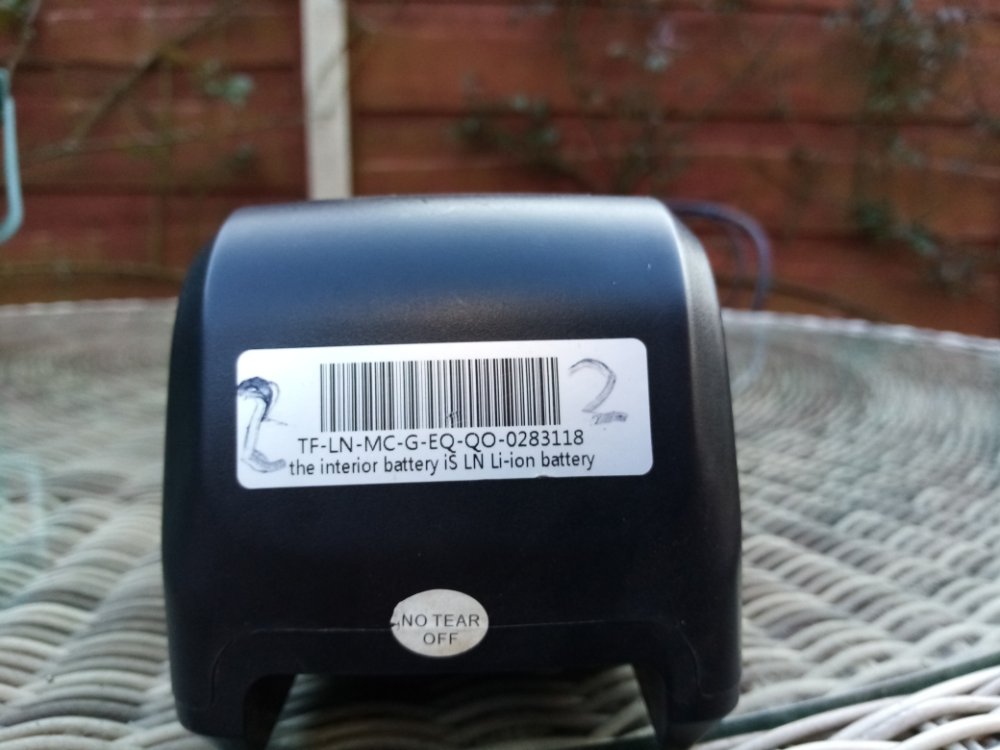

  13. Withdrawn from sale. I'm going to install it on a new bike.
