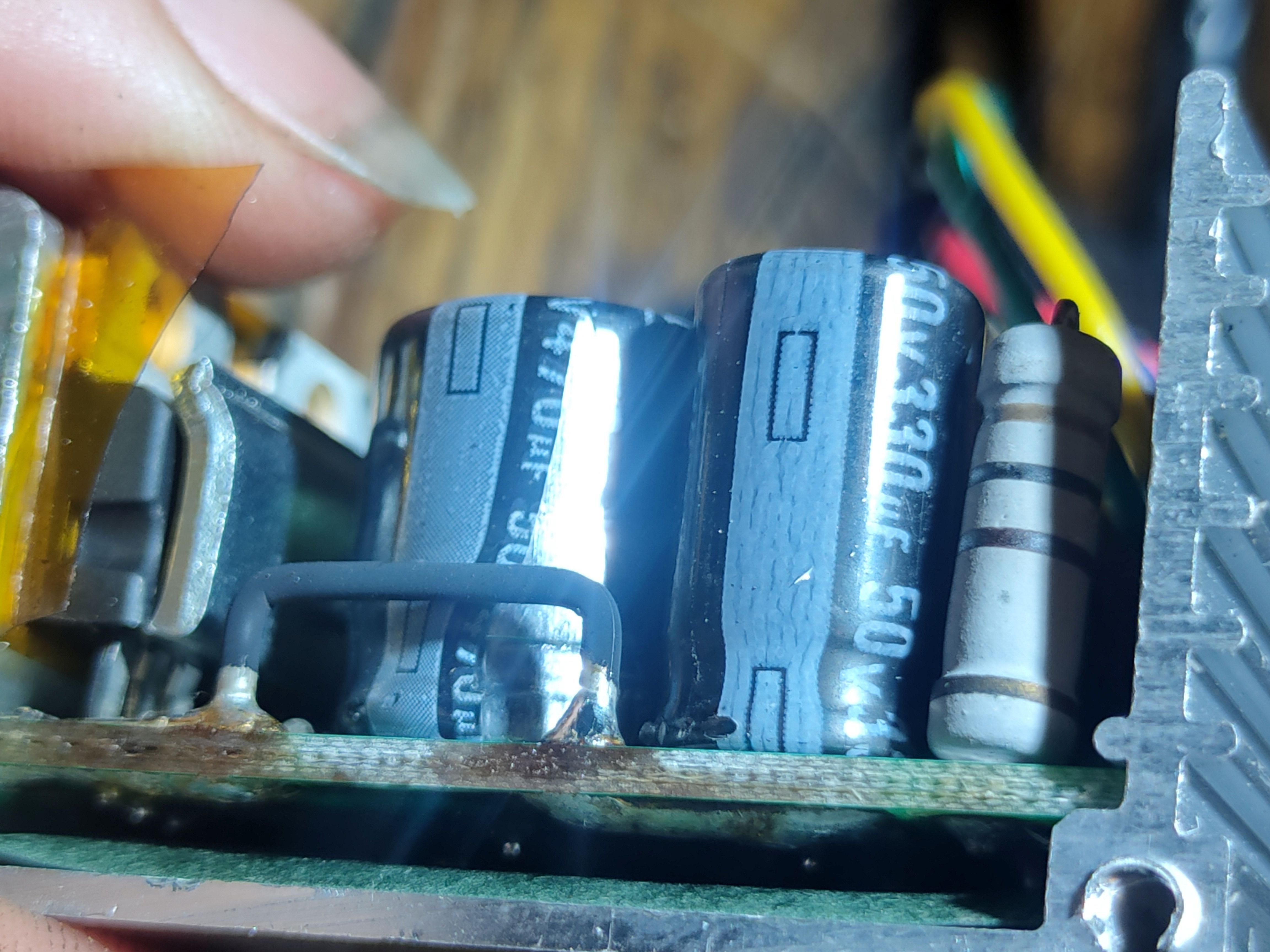

  4. The 470uf 50v capacitor showing the melted plastic covering
  5. Photos showing the blackened resistor and the two capacitors, one with a split plastic cover. The assumption is that the resistor overheated and transferred the heat to the capacitor causing the plastic to split in the process.
  6. I burnt out the previous motor after climbing a long and very steep hill. The heat generated by this probably contibuted to the eventual failure of capacitor. Ive no idea if the capacitors had a suitable voltage rating. I guess they did as the controller came as part of the kit.
  7. What do you want me to say? Visibly damaged capacitor was replaced. Ebike working fine now.
  8. It looks like the heat from the adjacent resistor (which looks like a wire link), which was excessively darkenened by excess current, melted the plastic covering of the capacitor and caused the top of the capacitor to expand. There was no visible damage to the mosphets.
