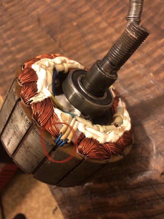

  3. Motor with single hall sensor without board on it !!!

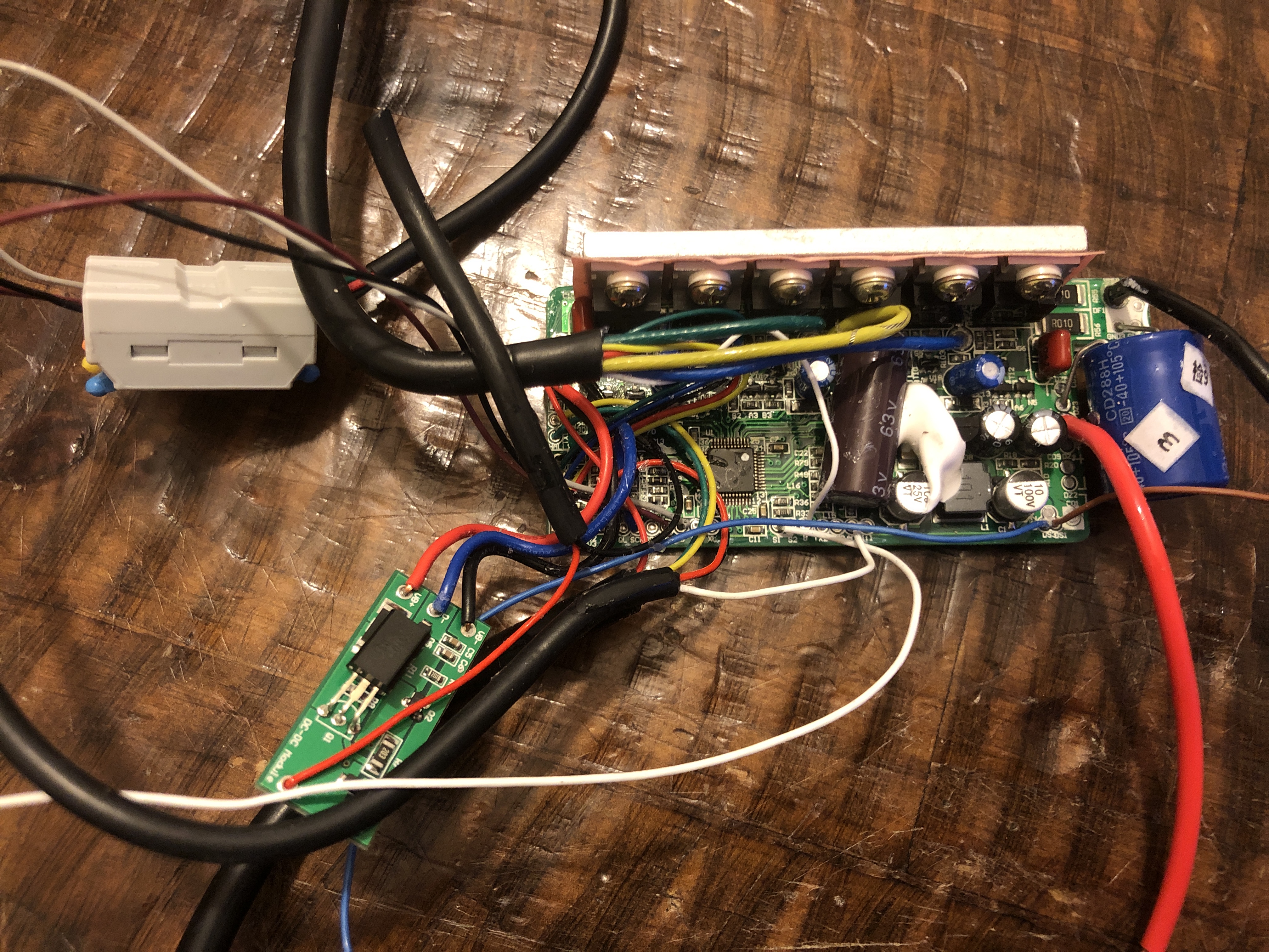

  6. This is another controller , everything good but also this one not running “the motor working very well with another controller “ , is there anything i miss to short like brake or something else

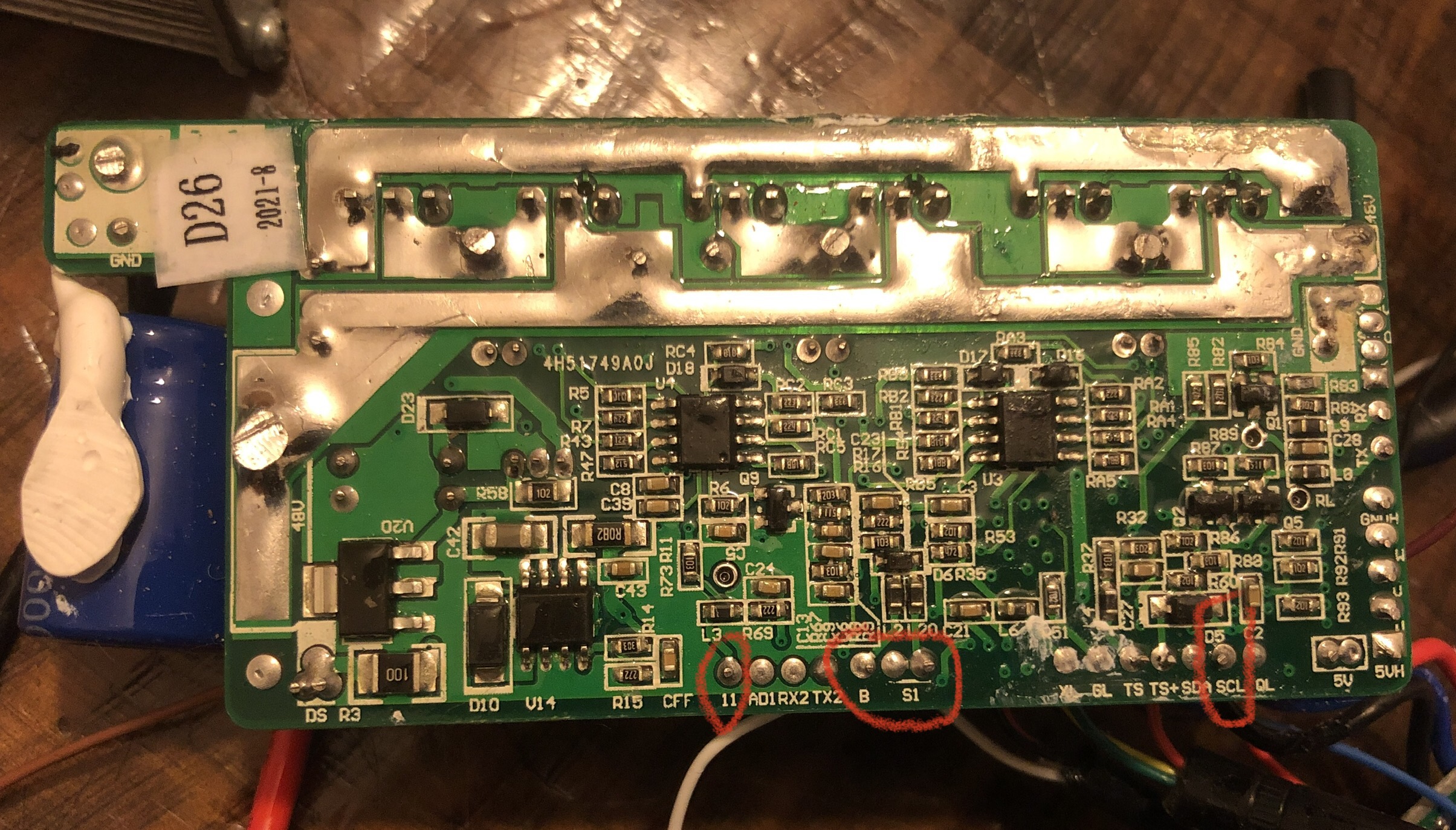

  11. Last picture i mark some pins anybody know what is it for ??
