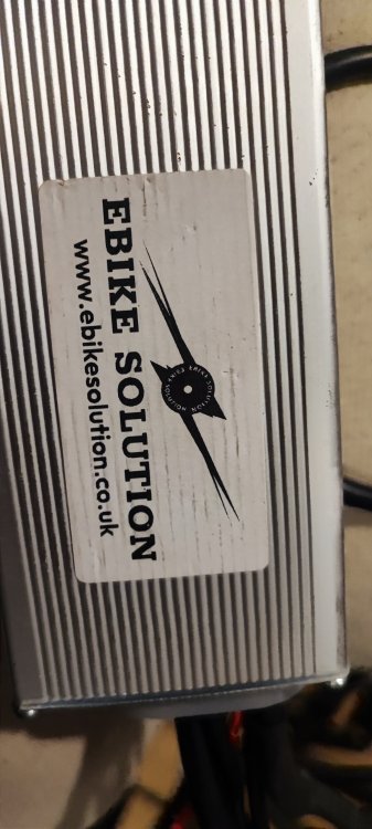

  7. I have 5 wires coming from the the Bafang controller display which are Orange, brown ,green ,black and white . From my display which is a Lcd 18c ,i have.red,blue ,black green and yellow. How do I connect them together which is the correct combination any help please .
  8. https://ebikesolution.co.uk/products/bafang-brushless-motor-controller-display-500c-ekd01-36-48v-15-25a-250-750w?_pos=2&_psq=bafang+con&_ss=e&_v=1.0 This is the website i bought the controller from 48v 22A as you can see yes it has a higo 3 pin connector containing red black and white wires for the pass sensor,if I understand you correctly I cut off the higo connector from the controller side. then cut the pedal assist side and solder the wires together hopefully colour by colour .
