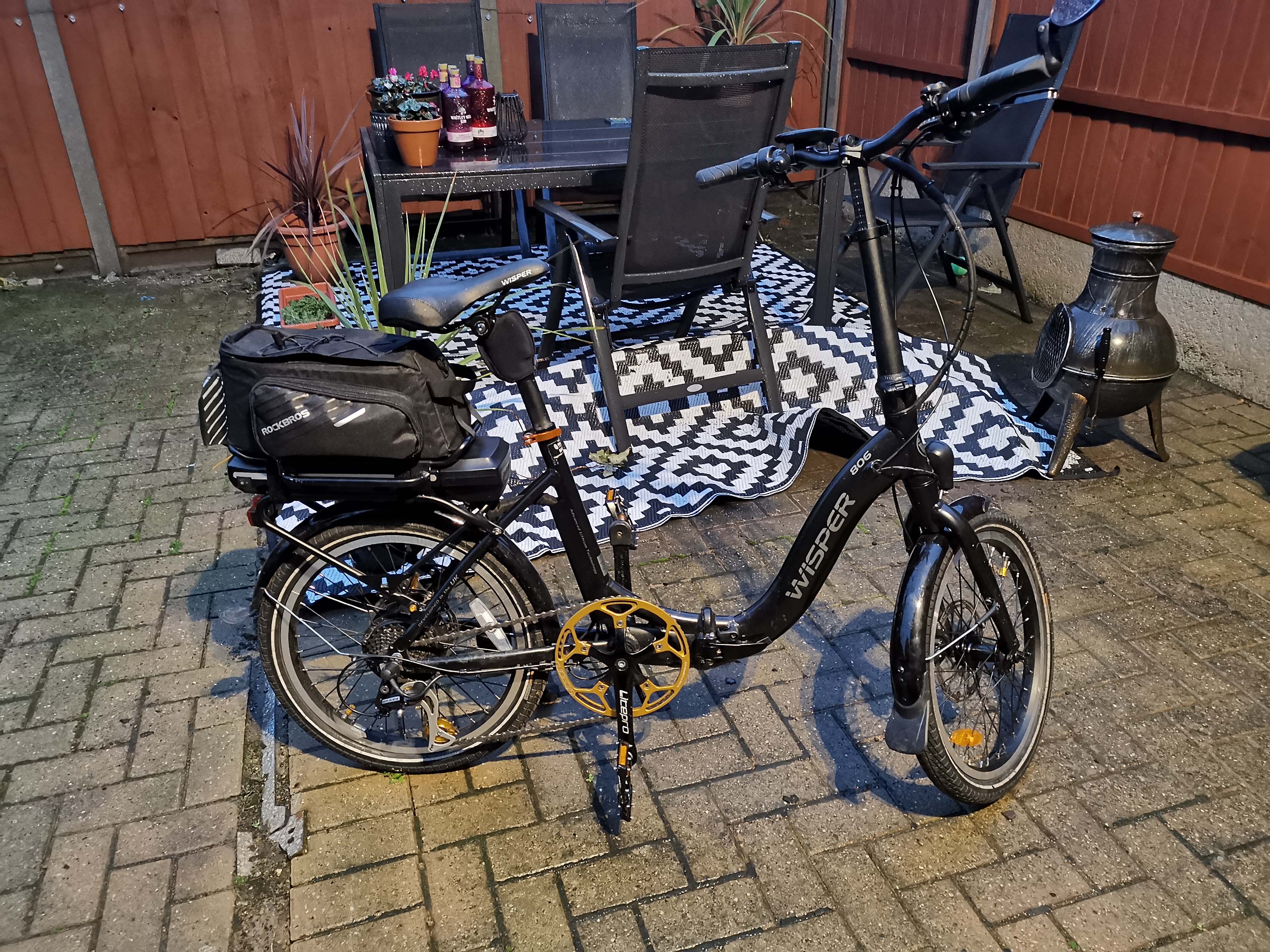

  5. [mention=40339]thelarkbox[/mention] I's 4 miles on the home side, and 1 mile on the work side (10 miles a day) so it comes with me on the train. This is what it looked like this morning. With proof, it's on the train.
