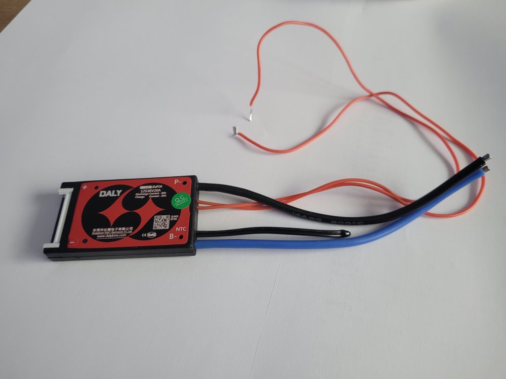

  14. It does show a switch I checked
  15. So I just recieved the new bms. This one looks like the two thin red wires are for switching it on and off or am I missing something?
