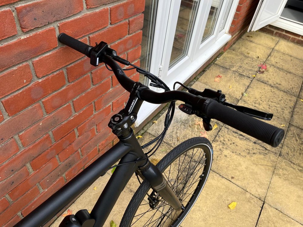

  3. Finally made the bike rideable, the only thing that isn't brand new is the frame which I stripped bare and had powdercoated. It rides really nice, but have ordered a different chainwheel as I can't get into the biggest gears on the cassette the way it is at the moment. I actually have two of these bikes now, one electric and one normal, I've tried to set them up so they are the same except for the motor, which included lots of measuring to the floor and the handlebars etc.
