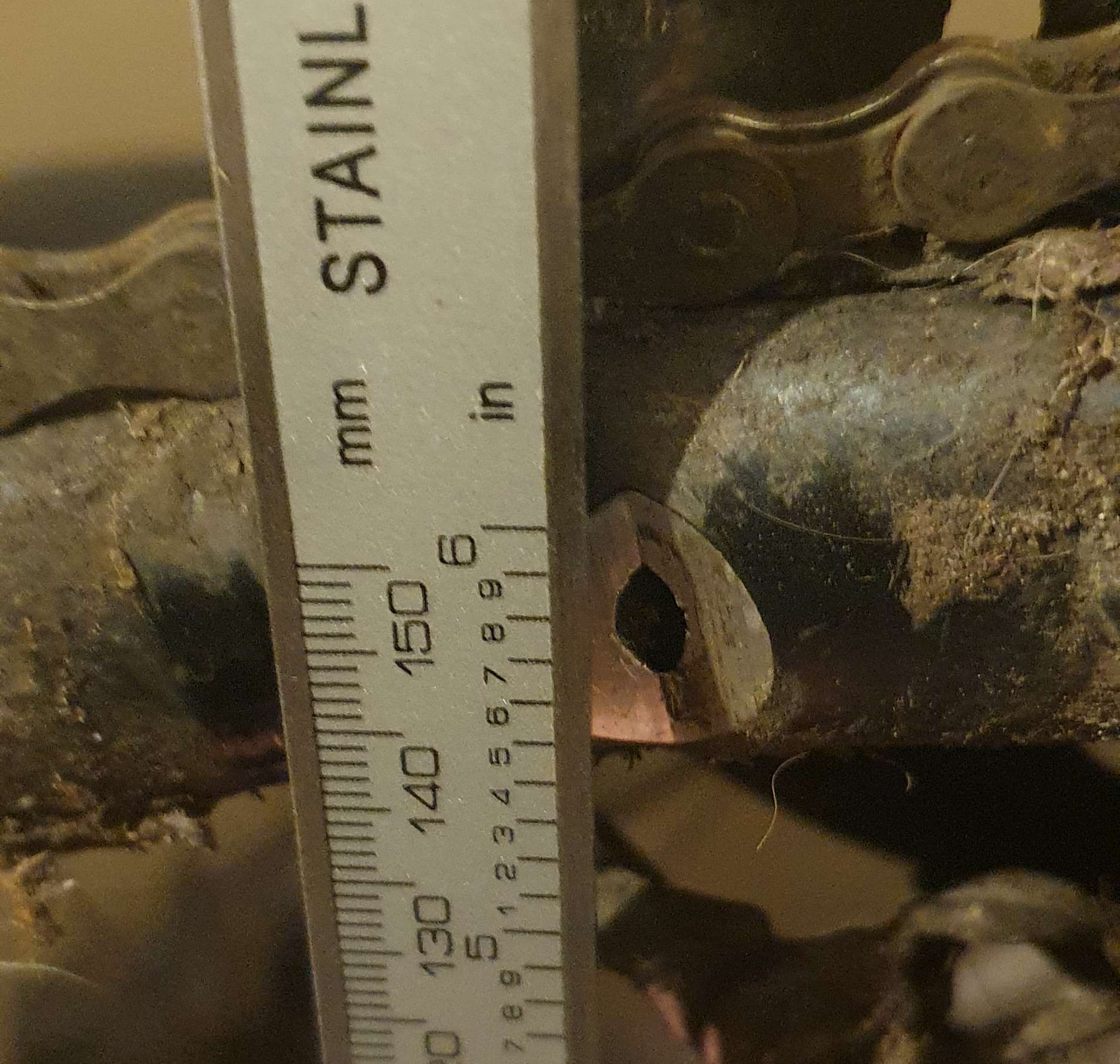

  2. [mention=18796]Sturmey[/mention] Yep, that'll be the pieces of assorted shrapnel that I'd plucked off the magnets. Didn't know it was a caged bearing. [mention=3847]saneagle[/mention] Removed all of the pieces of the bearing cage and tried running the motor again, still error 24, didn't even get it to move this time, last night it made about 1/20th of a turn. As you can see in the pic, some of the bits of bearing cage have cut through the enamel on the coil windings and are touching the board. So I'm guessing a either they touched, or a bearing ball rolling around in there touched that and sent about 36V to somewhere 36V shouldn't be. Also, the laminated cores for each coil have been bent out of shape. Seems like a wiser (and less time consuming, both in labour and waiting for parts) plan to just drop a new motor into the hub. Even if a new PCB got the motor running again, the scraped off enamel and bent iron isn't going to be a long-term solution. Though on the topic of bearings, would it be worth my time replacing the bearings these come with with better ones? Guess I might need a bearing puller (or just use liquid butane, outdoors to cool the bearing enough to tap it out, then freeze the new ones and heat the hub so they fit. Or are the stock bearings usually good enough.

  4. Well, I got it open. Though it opened up in a pretty non-standard way, as you can see, after just a gentle tap from the other side. Not looking good. Saneagle was correct in that it was a bearing that had failed, but there were bearing balls all over the magnets on the stator. Removed the bearing balls, plugged the motor in and carefully pushed the throttle, the motor moved about 1/20th turn before giving me Error 24 (Hall sensor failure) so I'm guessing one of the bearing balls managed to hit the PCB and short it out. They've also done a number on the outer part of the stator, unless it's supposed to come with hundreds of tiny dents as well as bent the laminated cores of the motor coil windings outwards. Oddly the inner and outer races of the bearing aren't cracked or shattered from what I can tell, so my best guess is that the races wore down over time allowing for the balls to fall out after hitting a bump. Took the stator of the motor out entirely and the hub gear itself looks to be in decent enough shape. So a replacement motor should give me enough donor parts to fix it up. I'll need to get a new cassette for it too, as this one is knackered.

  6. Was out cycling tonight and when about 8 miles from home heard my back tire start to rub up against my frame, followed by some metallic pinging. Had assumed a stick had got lodged between my frame and spokes or had been picked up by the tire, so after about 250 yards, pulled over and had a look, cleaned mud off and set off again. After about another 100 yards the tire was rubbing heavily against the frame and the popping/pinging sounds were a lot worse, so I took a better look. Tire has almost complete lateral movement (like if there was a catastrophic bearing failure on a normal hub) and can be moved from one side of the frame to the other with ease and the hub motor (AKM 350) won't drive any more (giving me an error code on the LCD, code 24, IIRC, I'll take a better look tomorrow), but it is still firmly bolted to the dropouts and the axle/motor spindle isn't rotating inside the dropouts. So, my best guess (after walking and cycling, with great difficulty, the bike home, getting home about half past midnight) is that either the axle has snapped inside the motor, or something has gone terribly wrong with the bearings, or the gears inside the motor causing a compound failure. Meaning I'm likely going to need a new hub motor. I bought the bike with 500 miles on it and it has just over 4200 miles on it now, so a part failure isn't exactly unexpected. If anyone has a recommendation for a new, reasonably priced, hub motor (and rear wheel) assembly; building a wheel up isn't exactly something I've got time for. Or good news like "It's probably just a blown gear" (though I doubt it is, seems more catastrophic due to the sway on the back wheel) I'd appreciate that. Ebikes (and your suggestions, I was initially going to get a 1500 watt motor which wouldn't have worked as well as this) got me back into cycling about 10 months ago and helped significantly with physiotherapy and getting back into shape, so it'll be a shame to lose getting out for a cycle until this is fixed. Anyway, posting this now as I'm more of a night person and I might get some good suggestions before I decide to open the back hub up tomorrow. EDIT: Motor is an AKM 350 rear hub motor, so it's got a cassette and freewheel on it.
