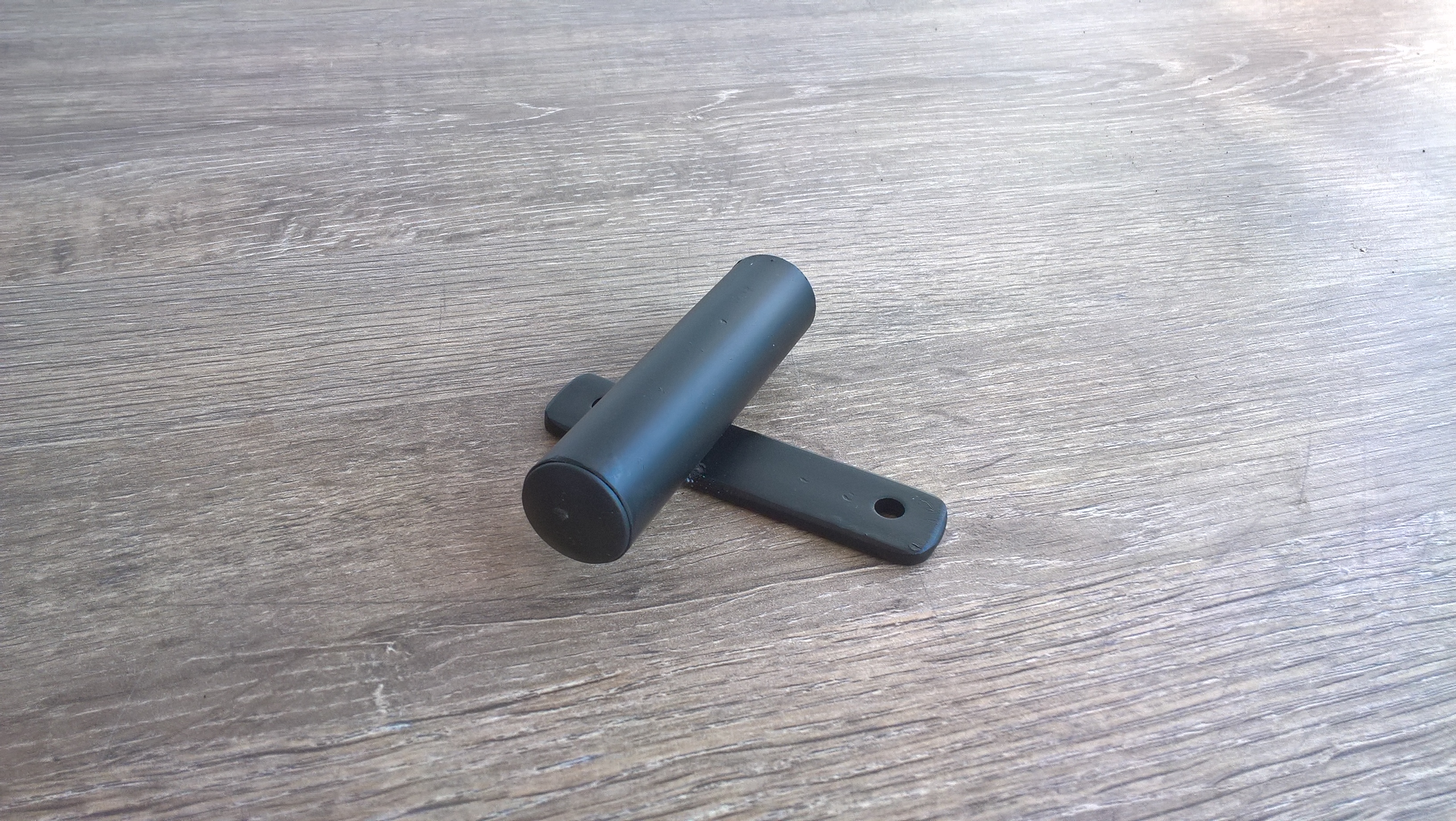

  3. None of the trike manufacturers recommend fitting a middle and battery on the front boom , apart from putting a lot of weight in front of the wheels ( modifying the handling ) it will put a lot of extra strain on the joint.

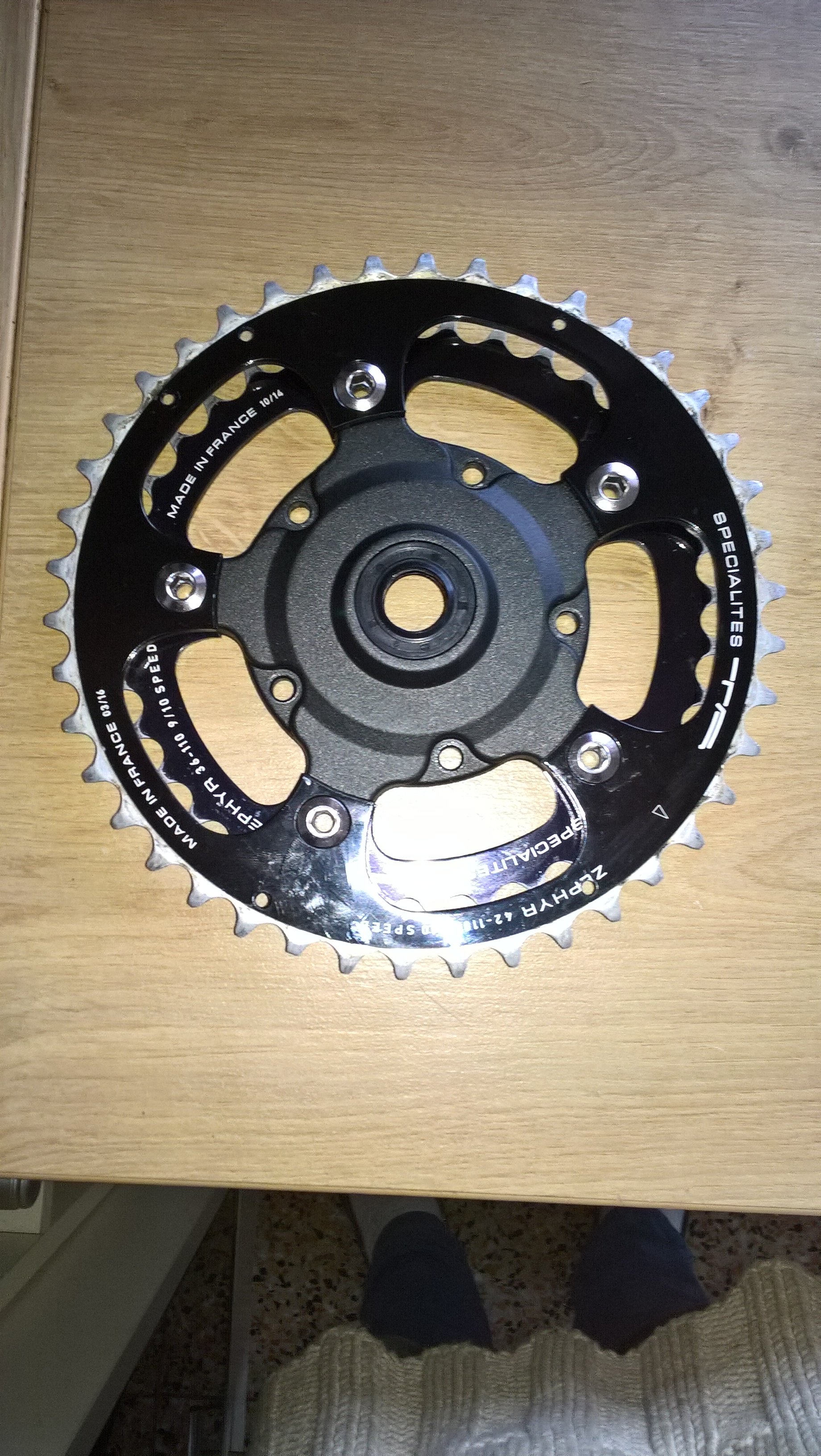

  6. Don't look like that supplier carries the thinner cables

  8. Hi Folks , Does anyone have any links for the thin multicore cables used on e-bike parts . eg throttle 3 and 4 core , brake 2 core and 5 core aux wiring . Currently stuck without a source . regards Emma
  9. Double chain ring installed .36/42t

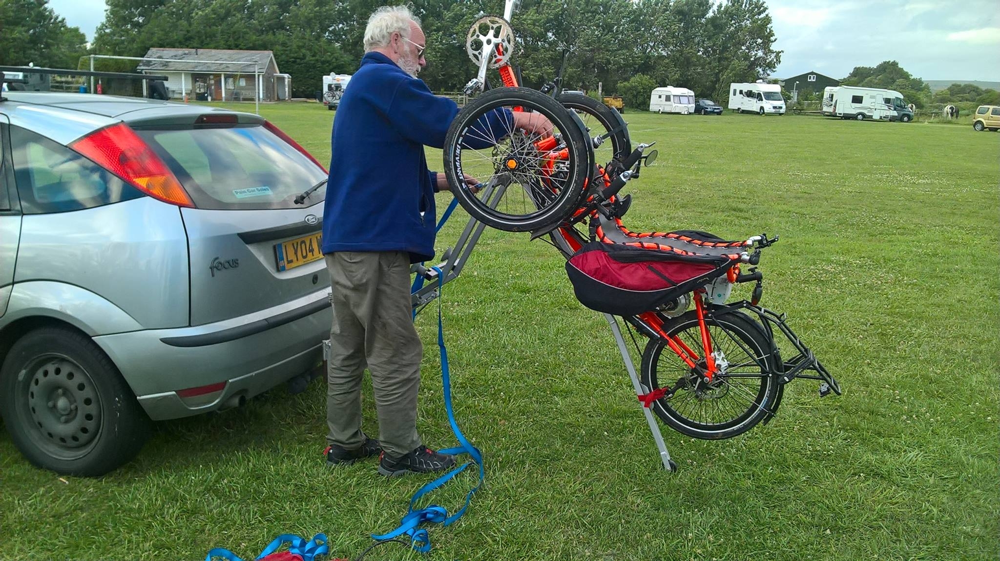

  14. A lot of the original photos have gone missing due to me using postimage as a photo host , sorry that is out of my hands. We lost my Friend John earlier in the year who was one of our Zombie fest group , John was a Triker and a very good engineer who designed and built the Folding frame on project X and his counter poise and balanced boot mounted trike carrier. He was only 70 and is missed by our little group . I will leave you with the photos of his unique trike carrier . Taken on our last camping trip together. John and a couple of his friends took their home built trikes on a few trips to Holland.
  15. reopening the old thread again , a lot has happened in the last 4 years . Both trikes have undergone many mods and upgrades and are still in use .We have now worn out the original batteries and have now a pair of new ones , the front discs have been upgraded to 8" discs and a new shaped seat made for both trikes , I lost mum last year and the past year has been very different for me .
