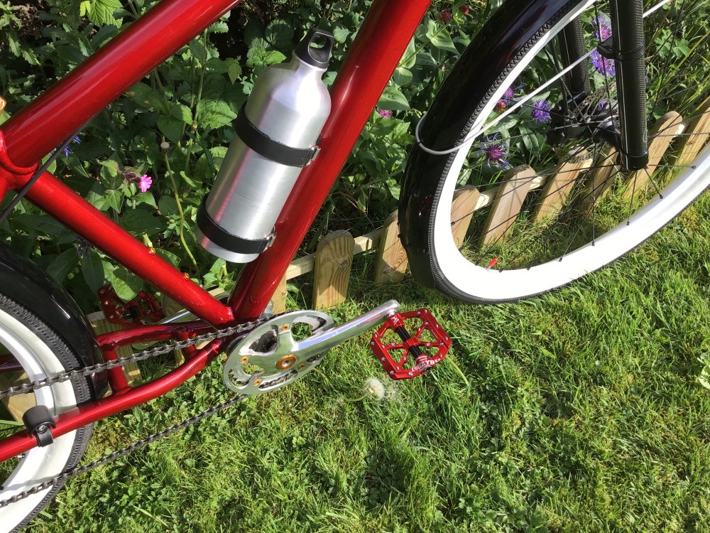

  9. 5mm standard thread for bottle cage mounting. If I remember correctly it’s a 7.1 mm hole for a 5mm rivnut and I’d also look for knurled nuts as they grip better with less chance of spinning in the hole

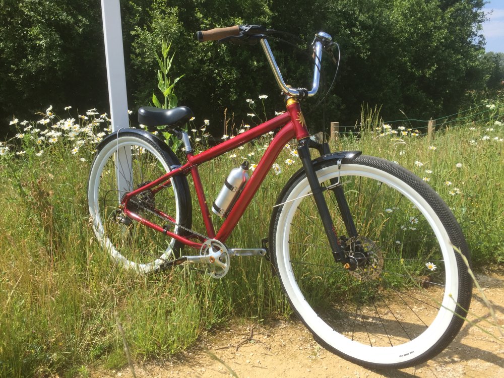

  18. During lockdown I had a frame shot blasted and powder coated candy red over a silver base £80, at that time a single colour was £60 I have used Halfords aerosols in the past , although they do a decent job the finish is not very durable (anything rubbing against it wears through quite easily) decals cut from sticky back vinyl
