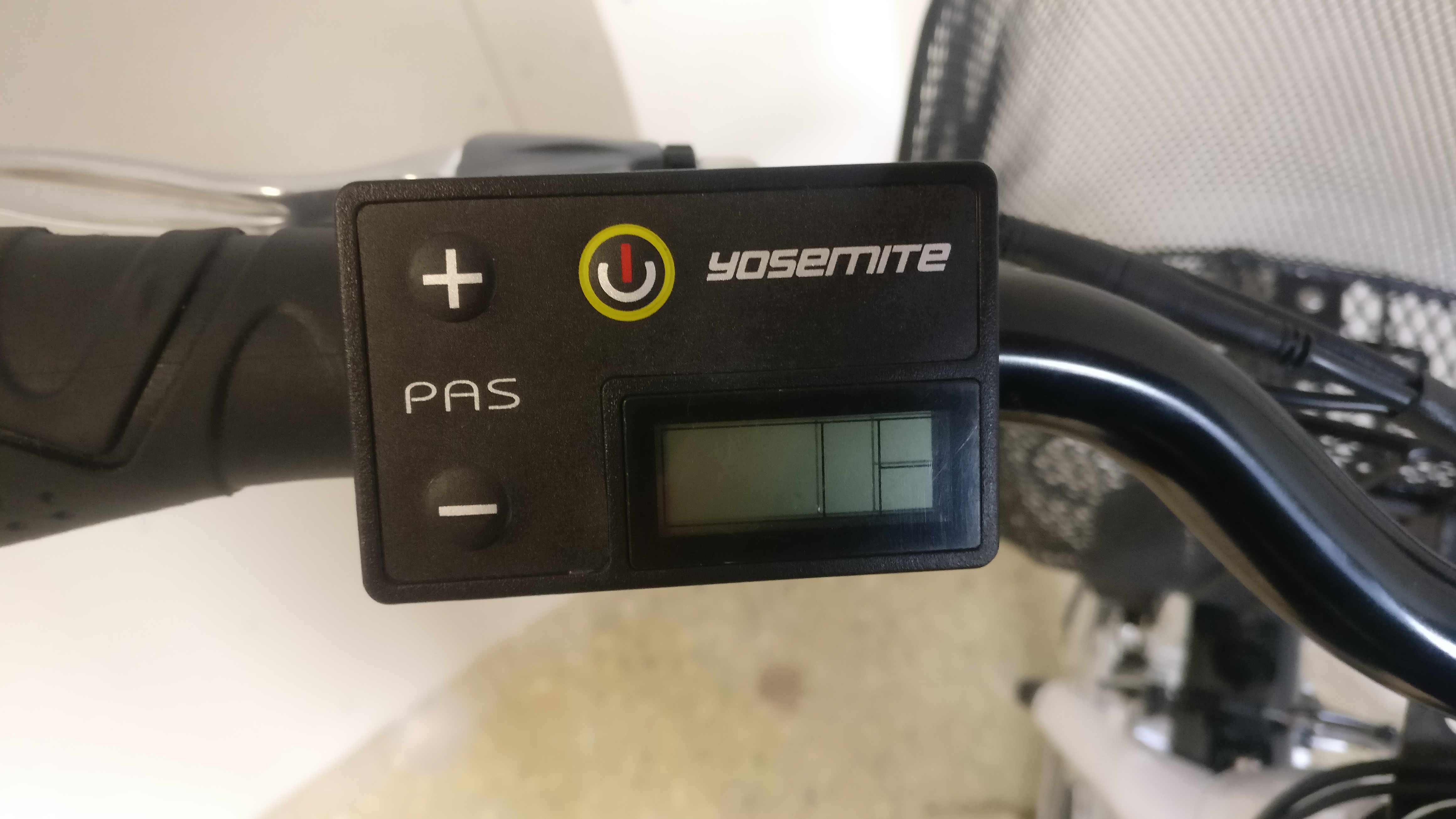

Hello, I have the yosemite biltema City sport 8 gear 6 speed.
https://www.biltema.se/fritid/cyklar/elcyklar/elcykel-city-sport-28-8-vaxlar-2000041081
Any way to unlock the speed limit on this one?
Theee are 2 loose connectors that fit each other, one measures 60v, now shown in pic connecting them fries something in the controller. Replacement on its way. Is there any way to unlock it? Disconnect white cable? It's in a different place than the picture from Andreas.
Pressing two buttons when starting gets you a C on the display, but there is not much else to do on the display as I knowIMG_20180906_093421.thumb.jpg.878744e2d1073cb3218ac1948a55ff3b.jpg IMG_20180906_093421.thumb.jpg.878744e2d1073cb3218ac1948a55ff3b.jpg
tmp_8042-IMG_20170404_0823461280240360.thumb.jpg.f67cb9e0776a4ad9303ed904d028173b.jpg
