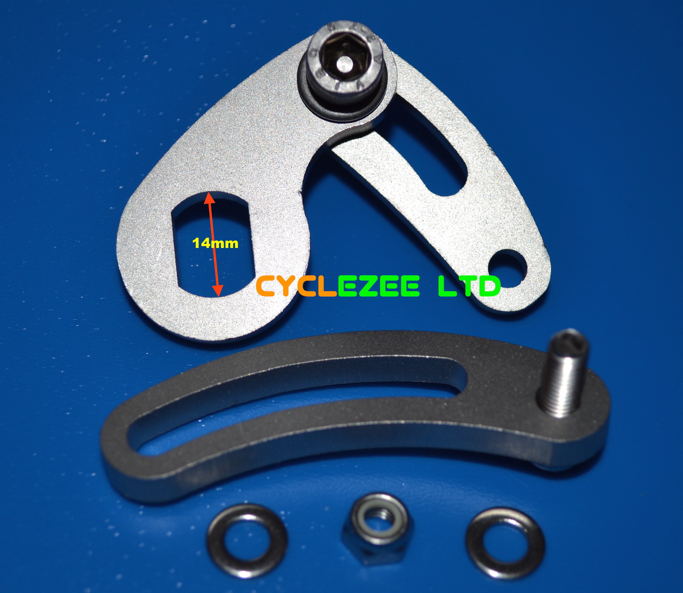

Now available, Cyclezee V3 Star Torque Arms in 2 sizes for 12 and 14mm diameter axles.
They are manufactured in the UK from 4mm thick hard stainless steel.
Our star type torque arms allow micro angle adjustment for fitting in a wide variety of situations for front or rear hub motors.
The free end of the arm can be secured with a hose clamps or 'P' clips which are readily available in a variety of sizes from good hardware stores or online.
They are priced at £12.75 including free delivery within the UK and can be purchased through our eBay listing here http://www.ebay.co.uk/itm/Star-Torque-Arms-Drehmomentstutzen-for-Electric-bikes-e-bikes-Pedelecs-/251882245061?
For 12 mm axles
For 14 mm axles
An example fitted to a rear hub motor

There is not a right or wrong side to fit a torque arm, just so long as it is fitted properly and prevents axle rotation within the dropouts.
Cyclezee have two different types with a 12mm and 14mm version of each as shown below.

Not if they are fitted and tightened properly, the Cyclezee V2 and V3 torque arms have a sand blasted finish for increased friction to prevent prevent slippage.
They are manufactured in Milton Keynes by an engineering company that makes parts for McLaren, Red Bull, Mercedes F1 teams et al, we have sold hundreds of these worldwide and the some customers come back for more.
