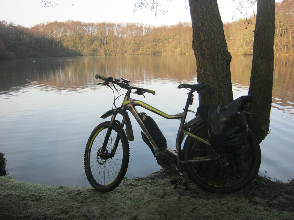

The above picture shows the great benefit of getting out of your car on your journey to work.
