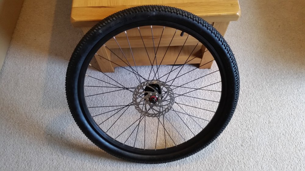

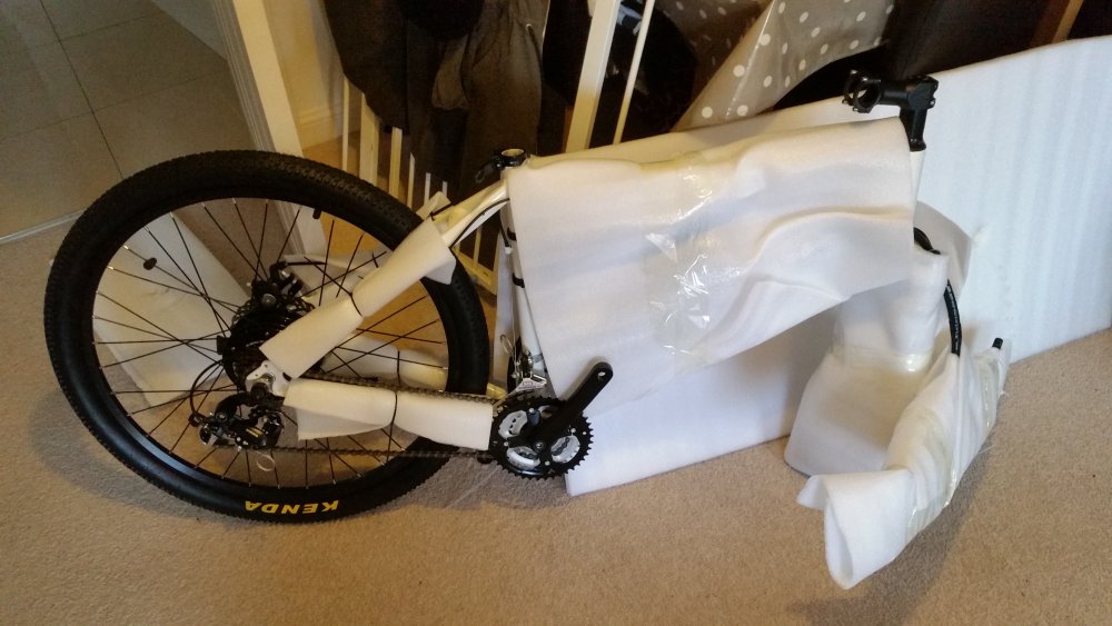

Putting together was pretty easy, with good instructions you download from the eco site. In fact the instructions are very detailed, including do's and don't's, and service information too. All the shimano instructions were included. There are also two allen keys and a wrench. Although the seat angle adjustment, required another size allen key.

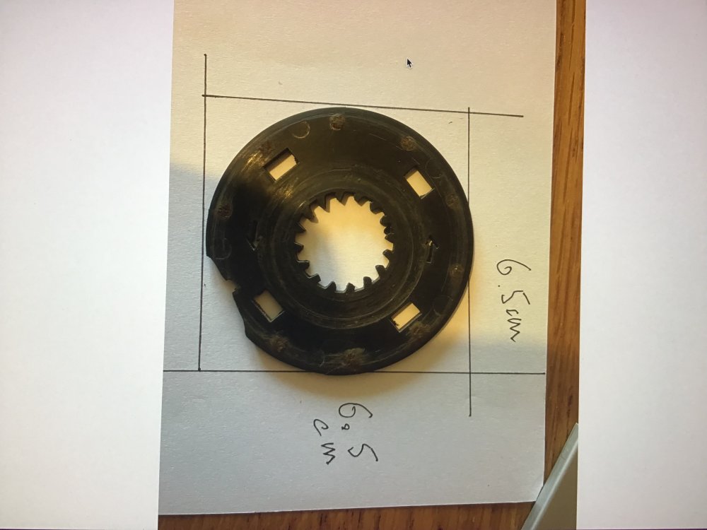

I’m in Kent. The bike’s problem is that the power surges, then cuts out, surges briefly and cuts out. In the past the sensor seemed to be the problem. any ideas?
Can you take some photos of the sensor? Where about in Kent? Your problem should be very minor if at least the motor does something.
Thanks for your reply. I am near Tunbridge Wells. The motor is fine. I took it to an electric bike shop in Woodbridge and the bloke said that many of the wires in the black box had been cut and bodged back together. Odd as the box has never been opened. I have a photo of the old sensor which was replaced. I’ll send the pic separately because I have to find it in my computer.
Louise
That’s the broken one that was replaced and the problem was sorted. I can take the one off the bike if it would help.
You've given enough info. There are two things to look for. Firstly, that black disc must be an even 1mm from the actual sensor that sits next to it with a wire coming out. If your chain comes off or it's not on tight enough, it can move away, then it won't work properly. All you have to do is wiggle it back into position. Secondly, if they're too loose on the shaft, instead of turning with the pedals, they start slipping. You can check that by watching it while you turn the pedals and/or put a finger on it lightly to see if that holds it still while the pedals turn, which it shouldn't do.
After that, you have to check that the wire isn't damaged, then follow the wire to the controller and check the connector there to see if there's any corrosion or other problem. All these things are pretty easy to check and only take a couple of minutes.
