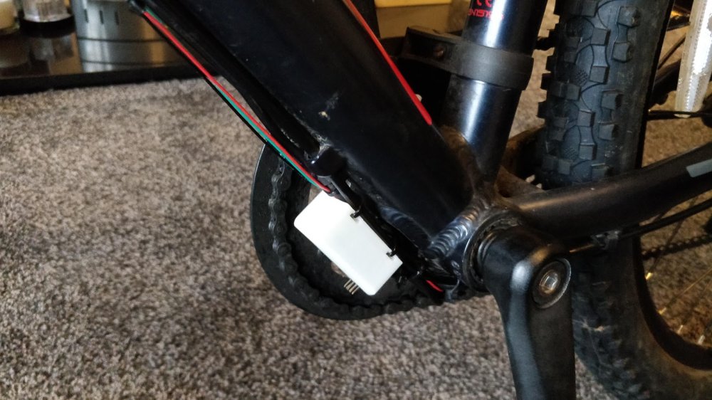

3D printed Arduino Nano temp case

Just waiting for my Arduino nanos to arrive without soldered pins so I can insert it into the frame and get it out of the way.
